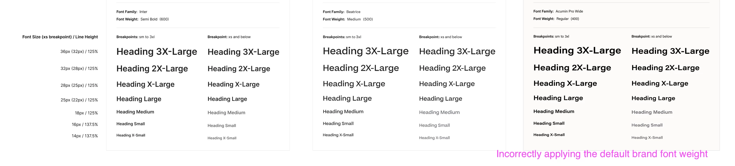

    Hello, I’ve been experiencing this issue off and on as well. Today it started happening again. It’s as though the default brand’s font weight gets “stuck” and attempts to be applied to some or all of the other brand fonts. Sometimes there isn’t a matching equivilant which causes the display to be even more off.
    In this example, the default brand (mode 1) font uses “Semi Bold” and the mode 3 brand spells it “Semibold” which results in it falling back to Bold. The mode 3 brand actually uses Regular, making the display error is very prominent, which is how I noticed it was happening.
    The only way I’ve found to correct it is to restart Figma and manually reapply the fontWeight variable to each font style and component referencing it.
    Expected Values
    Results when the bug is happening (see mode 3 brand)
