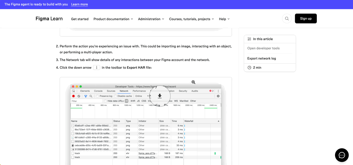

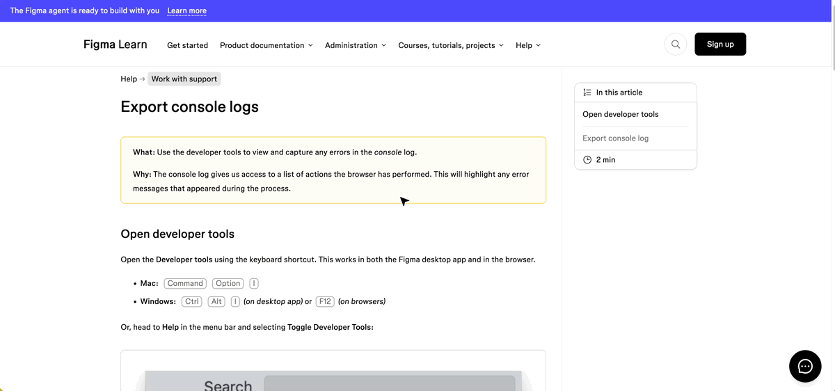

Hey ​@Peter Scott 👋 The team asked for two things:
For both; the article shows you exactly how to:
  • Setup your browser dev tool
  • Capture each of the logs after you [do the thing] 😊
  • Here are two quick gifs showing how to do this
Once you get both, send me a DM and we’ll get you a way to get those to us securely.
Talk soon! — Jaycee
