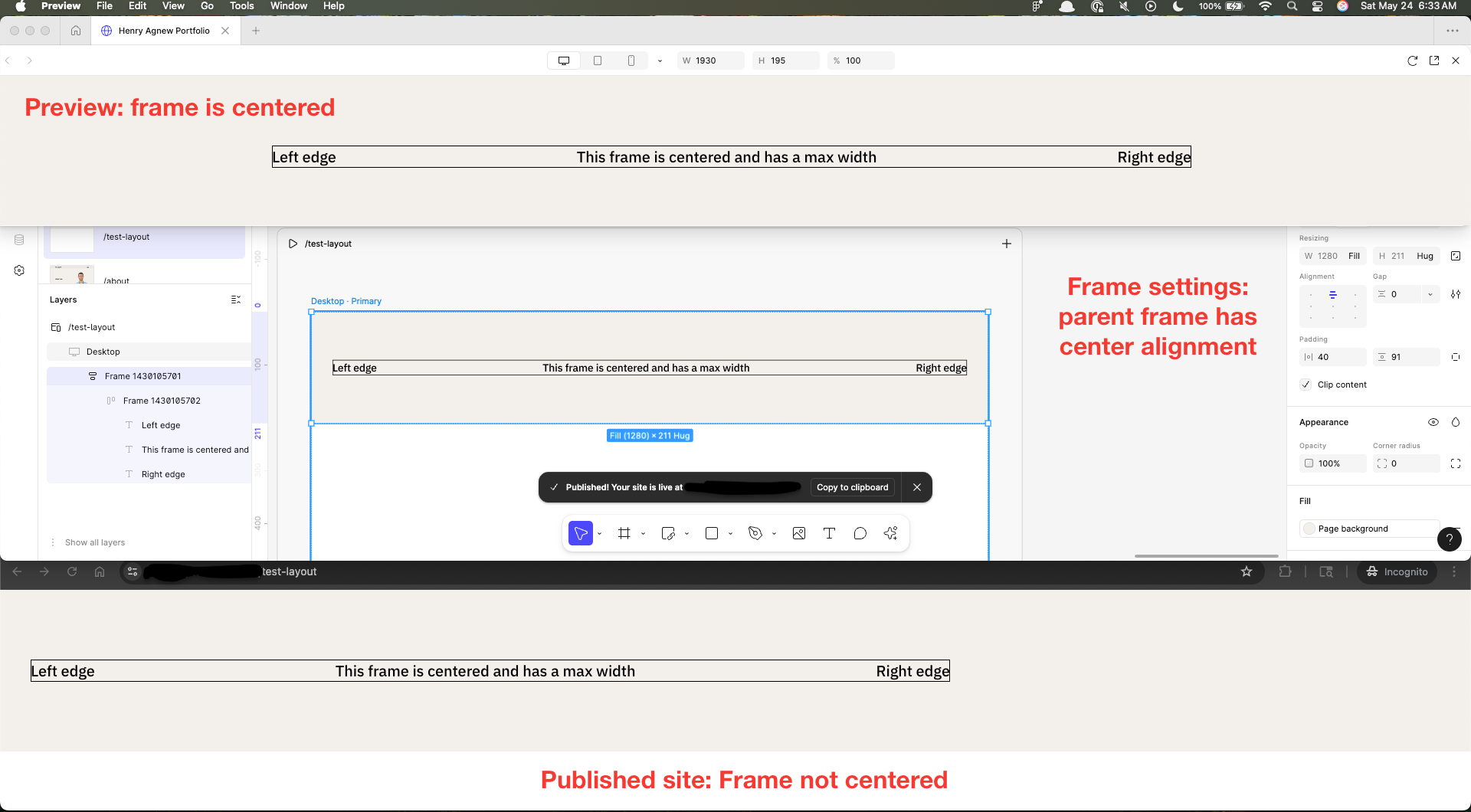

Henry Agnew
Hi! I first had this problem today, with designs that previously published correctly: center-aligned frames are publishing as left-aligned divs. See example below showing (top to bottom) 1) Previewing page within Figma Sites, 2) Autolayout settings, 3) Published page as displayed in Chrome

Bagas Al Haekal Nasution
I Have the same issues today
Jafari Mulla Ghany
I also just encountered this issue/bug, in the previous version it was still aligned center when published, but today when I did an update in the design and then published it again, it became aligned left even though the parent was already aligned center. Is this a bug that has not been solved or maybe there is already a solution?

I also have the same issue. Last night, I spent quite a lot of time thinking I messed something up. I tried rebuilding the whole page section by section, and it worked at first but suddenly broke randomly and became unfixable.

Same issue here, noticed today after publishing. It doesn’t happen for all frames, but I don’t see a pattern.
I also remember this happen once more some days ago, but it got fixed once I re-published. Unfortunately this doesn’t work now, I’ve re-published and it’s still broken.

I have the same problem. It’s centered while I’m editing it, but when I publish it, it’s aligned to the left.
ana.bolio.ayora
Im having the same issues. Is there a fix? The prototype looks fine but when i publish, it aligned to the left, even if i align it to the right

Hi all,
Thanks for your patience. Our engineering team has deployed a fix. The issue should now be resolved! Could you please try either reloading the file or restarting your Figma app?  Let us know if the issue persists.
Thanks again for flagging and your patience!
