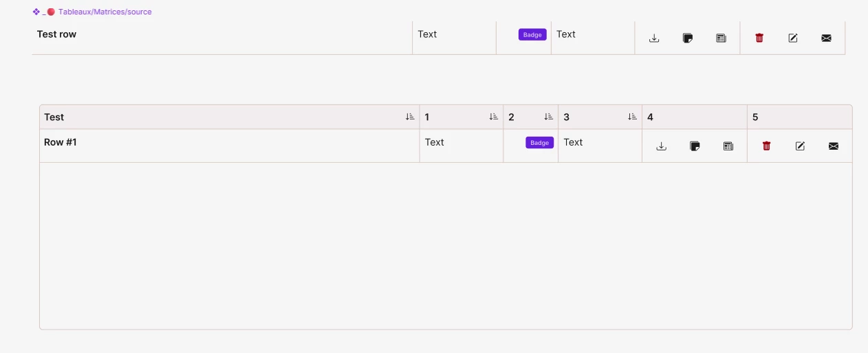

Julien_Dedale
Hello,
Hello, I'm having the same issue: component instances added to table row slots disappear from the slots or flicker and move constantly within their container. Sometimes they don't display at all. Sometimes changes made to one component instance affect other instances even though the main component hasn't been modified, and sometimes changes to an instance even affect the source component!
It's even worse if I create a component based on this table and add an instance of it to the page: it doesn't update and behaves erratically.
The row component contains slot for each cell.
Screenshot 1:
  1. Instances in row slots doesn’t show at all. Eventually the content appears if I click around

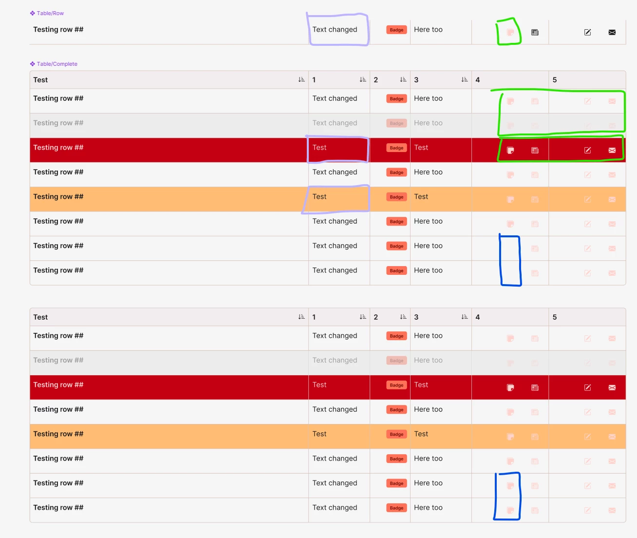

Screenshot 2:
  1. Changing the row variant to “error” (the red one) change the icon color of all the instances and even the source component, in a twisted logic instance > main (green outline)
  2. Text changed in main row component does not change in instances (light purple outline). On the screenshot, it’s only on the variants of the component, but few minute before the text was identical on all instances, before I click on the object.
  3. Hide icons on the main table component don’t hide them in the instance (blue outline).
Also each time I work with this kind of configuration/file, I can’t close Figma because the document have “unsaved changes”.
It’s very hard to use components with slots right now.
Instances are in the table, but invisible. The space is taken by the invisible instances.
Purple outline : Test changed in main component but not in instances.
Green outline : Variant change on one instance, icons color changed everywhere EVEN on one icon of main component.
Blue outline : Icons hidden in main component but not in instance.
