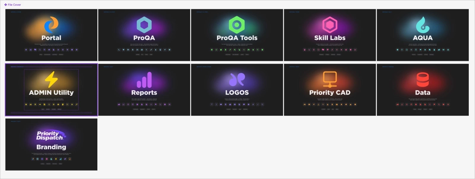

I use a cover page in each product file and set the cover frame as the file thumbnail. The cover is an instance of a component from our shared library, so updating the main component updates the cover in every file.

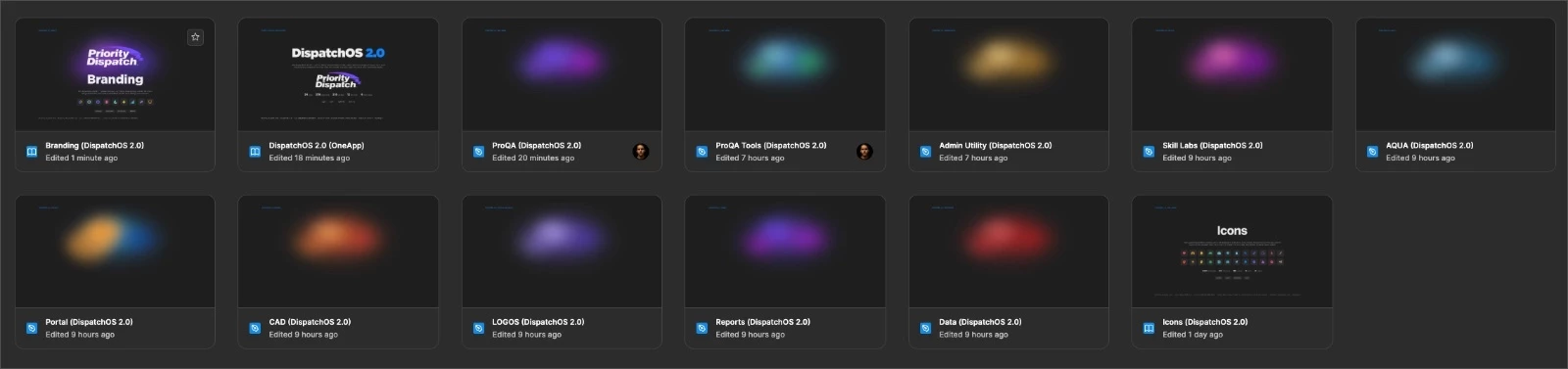

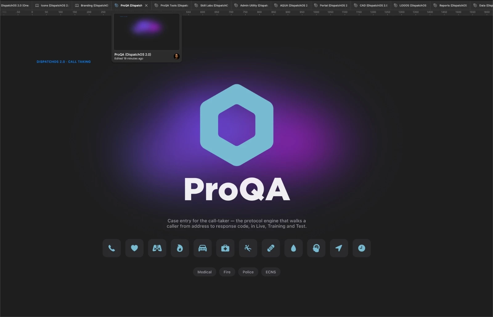

When the thumbnail frame is a component instance, the elements inside it don't render in the file thumbnail. The file browser shows only the background glow; the logo, title, description and icons are missing.
If I right-click the instance and choose Detach instance, the elements come back and the thumbnail renders correctly.

4. Look at the file in the file browser: the thumbnail is missing most of the content.
5. Detach the instance: the thumbnail renders correctly.

Screenshots attached: the cover components rendering correctly on the canvas, a cover instance in a product file next to its broken thumbnail preview, the file browser showing the broken thumbnails (the Branding, DispatchOS 2.0 and Icons covers are detached and render fine), and my app version.
