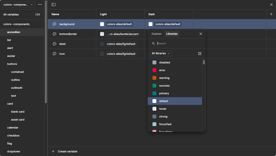

Figma Variables - Dark Mode Not Working
I’ve created separate collections for alias colors and component colors. Within the Alias Colors I have both Light and Dark Modes.When I try to apply the dark mode alias colors to the dark mode component, I can only see the Light Mode colors from the dropdown.
This is new behavior. Earlier this week, figma was recognizing that I was in a dark mode column for the component variables and applying the corresponding dark mode alias color. Has anyone encountered this?  Is this a bug?

Hey ​@Camille_Woods — thanks for bringing this up. I’m checking in to see if you’re still running into the same issue with dark mode not applying as expected.
I tested this on my end but wasn’t able to fully reproduce the behavior you described. If this is still happening in your file, I wonder if there might be a mode conflict at play. This can sometimes happen when variables from different sources interact. You can learn more in this Figma Learn article: Modes for variables → Mode conflicts.
Here are two solutions that may help resolve the issue (see Prevent mode conflicts for more context):
  • Scenario 1: Make sure any changes to the variables have been published, and that those updates are accepted in the file showing the conflict.
  • Scenario 2: If you’re working across multiple files with connected assets, you’ll want to publish and accept updates in all files involved, in order — starting from the source file and working outward.
Appreciate you taking the time to check on these suggestions. Let me know if either of those clears things up, or if the issue is persisting. I’m happy to escalate for a deeper look into the file you’re working on — really want to make sure this gets sorted out. 🔍
