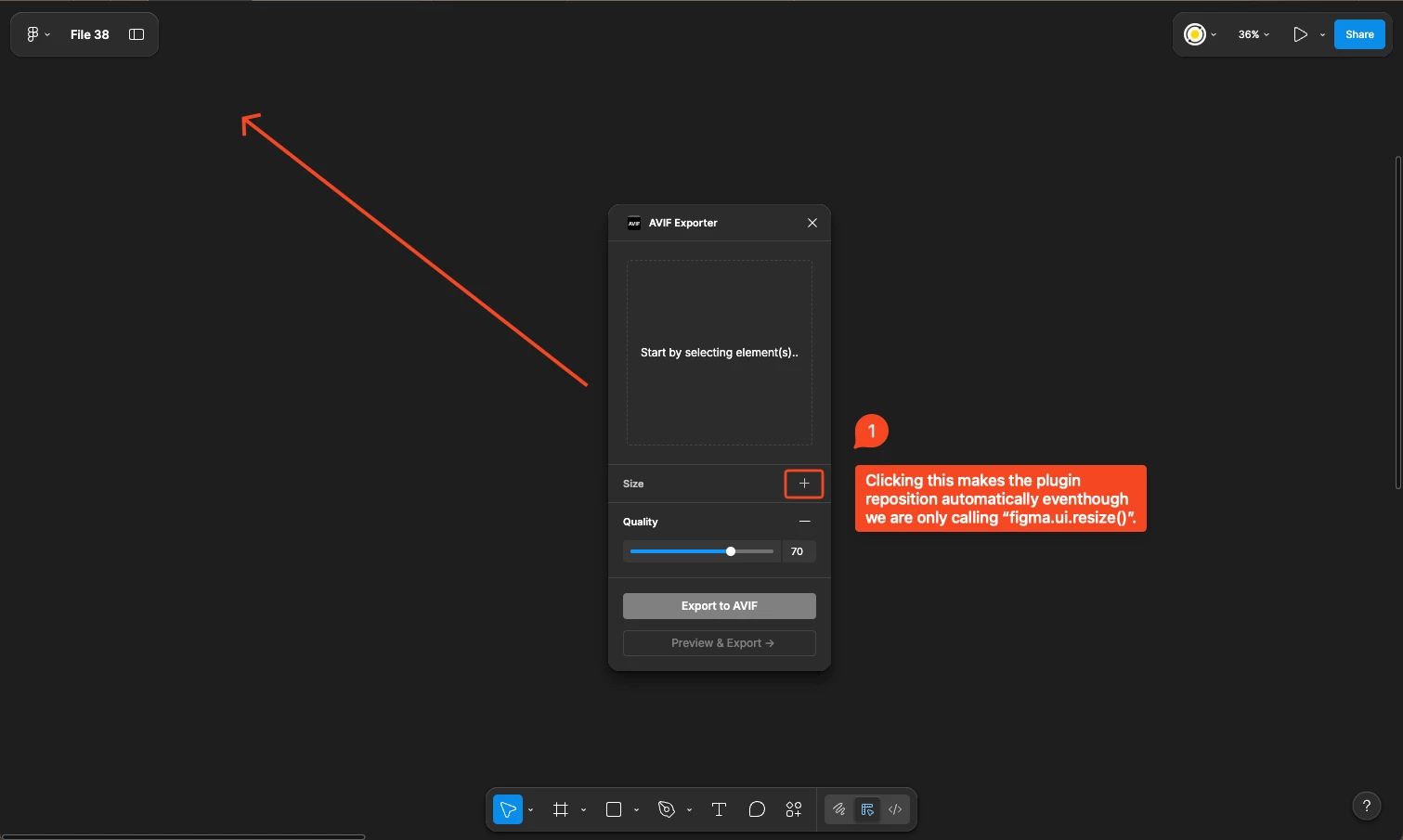

figma.ui.resize also repositions the plugin ui.
Hello Everyone,
We are the developers of the AVIF Exporter Figma Plugin.
We have just noticed that recently, when someone tries to expand/minimize the “Size or Quality” bar, the plugin repositions itself to some other position automatically.
We do figma.ui.resize behind the scene to support that feature, we are calling only that function, but it also seem to be repositioning the plugin.
This didn’t happen before. We have also observed the similar behaviour with other plugin automator .
We think there some bug with figma plugin API or figma itself.
Before the `resize( )` call
After the `resize( )` call

+1 same started happening to us in Cloudinary plugin

Hey all - sorry it has taken a moment to reach out. I checked in with the team that work on extensibility (AKA plugins/widgets), and there was a regression that happened around the time you all reported this. It should now be fixed -- can anyone confirm if you’re still running into issues with this?
If so, please let me know and I’ll bring that information back over internally.

Hey ​@ksn,
Thanks for replying.
We just tested the function again, it seems to be working as expected (fixed).
