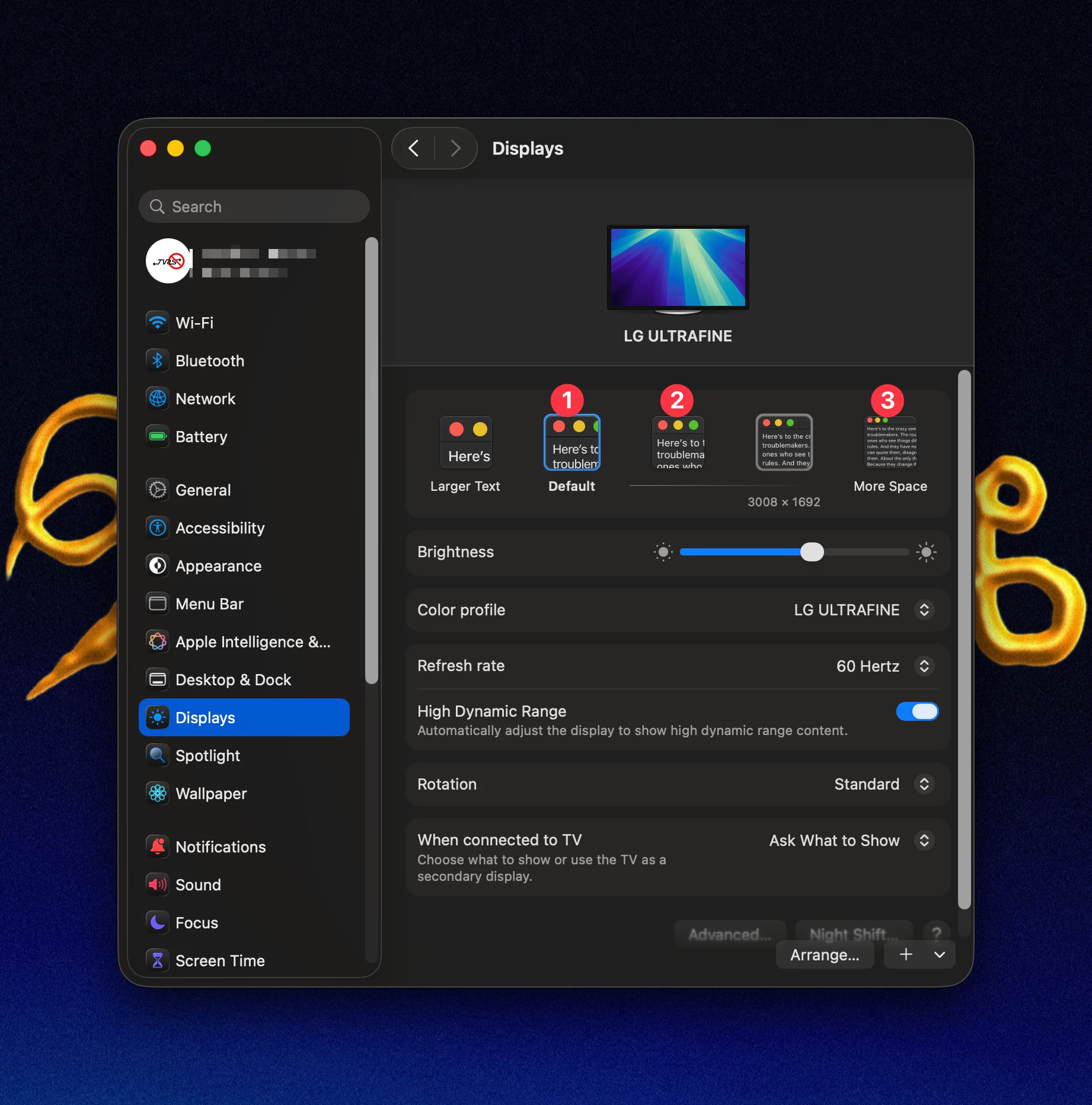

Update: After several tests, I've discovered the issue is related to my External Monitor and MacOS UI scaling options (see attached images).
I typically use option "2" for my 27" 4K monitor because the UI otherwise appears either too large or too small. However, MacOS warns that "using a scaled resolution may affect performance," and indeed, Figma lags when using this setting. Switching to full resolution (option "3") or Default "1" makes Figma much more responsive.
In "Default" mode, everything in MacOS appears larger than I'd like, but at least Figma runs almost smoothly.
FYI, the MacOS resolution list is somewhat misleading. If your screen is 4K, the image remains 4K regardless of which "resolution" setting you select—these options only control UI scaling. So even though settings below "Default" show dimensions like 1080x1920, your 4K screen still displays at full resolution.
If you try this solution, please let me know how it works for you!

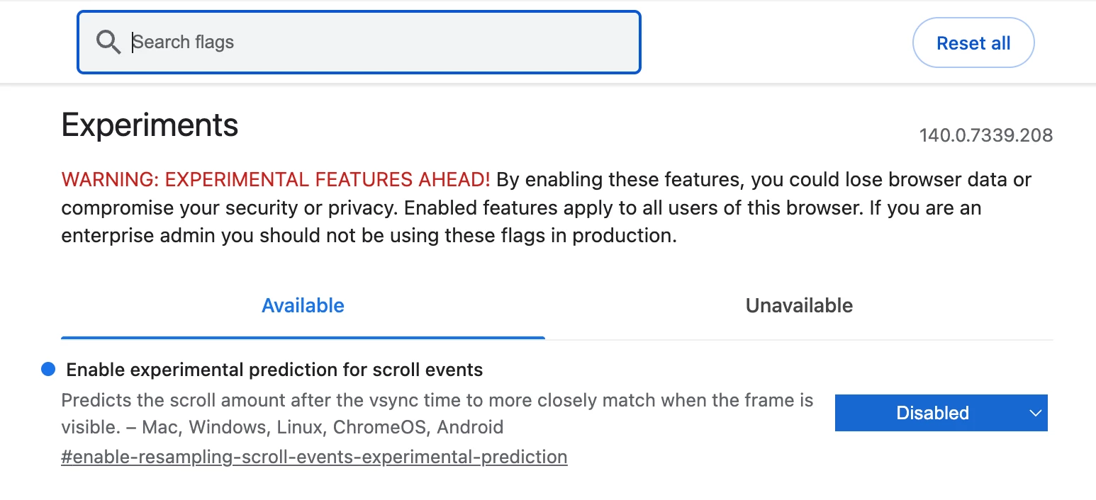

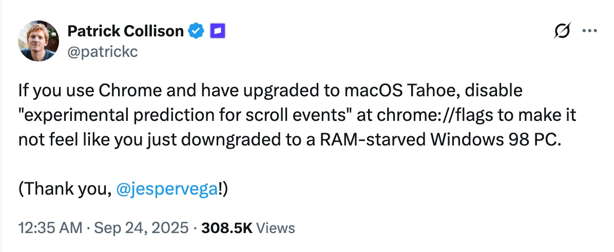

In the meantime, I stumbled upon something very interesting on Twitter about the performance issues on Tahoe. Someone suggested disabling an experimental flag in Chrome/Chromium browsers (Experimental prediction for scroll events) that might cause significant lags and slowdowns.
I decided to try it out and restarted my browser. After that, the performance completely returned to normal on the browser (Dia), and surprisingly, the lag issues completely disappeared from the Figma app as well!
It seems like there might be a connection between this experimental flag and the performance issues. I hope this helps the engineering teams.
Thanks again for your support!

​@ksn I submitted a form but myself and other Mercury designers are seeing this issue with macOS Tahoe. The @patrickc Twitter patch and screen sharing from Chrome-based browser resolves this issue for me. I hope this helps the Figma team develop a performance patch for the native app.
