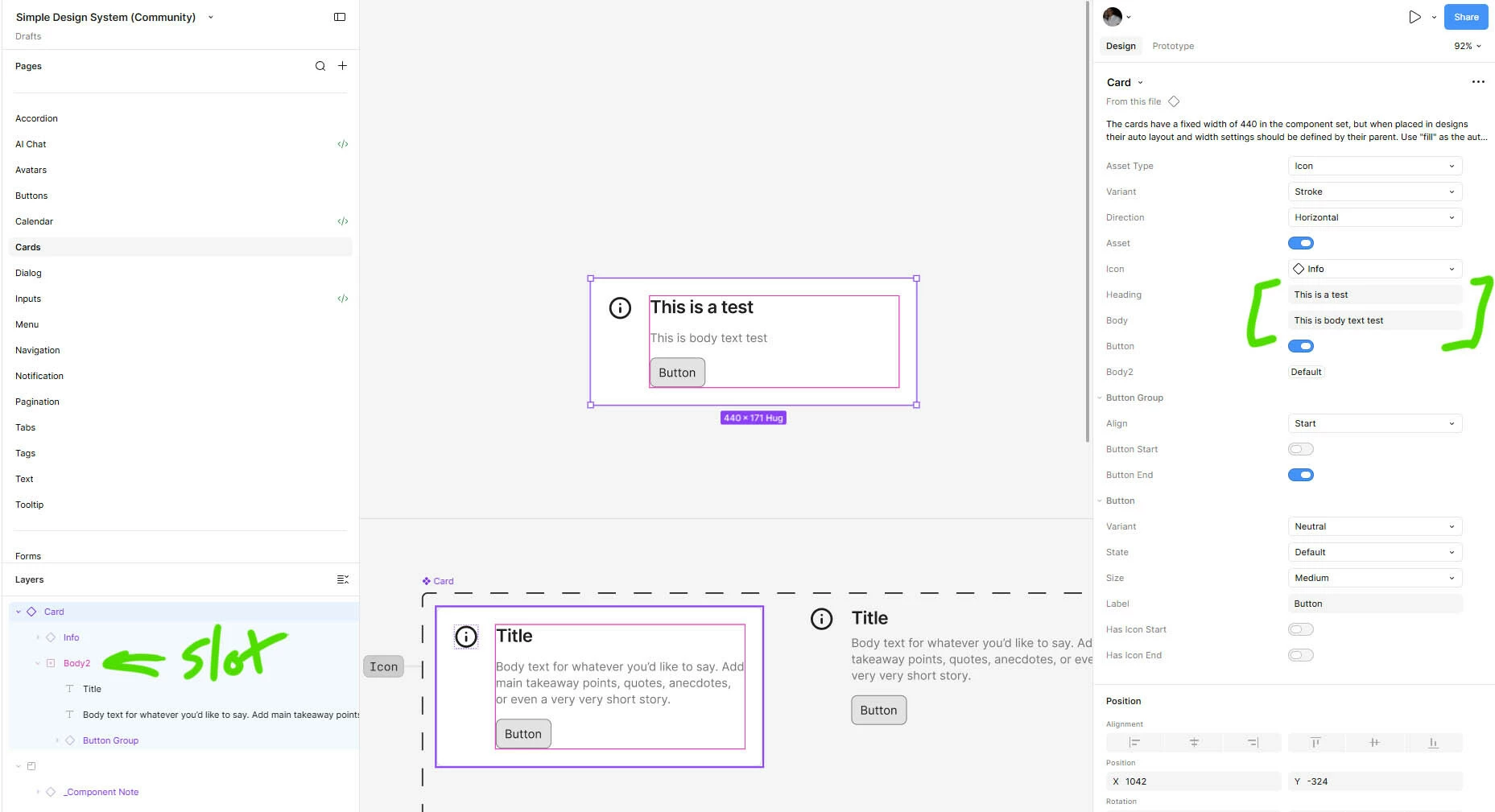

​@Celyn_L This doesn’t seem to be the case as Figma’s own Simple Design System allows for editable properties on elements within slots. See Figma’s card component example below (card instance selected, not variant).
Experimenting with my own components its buggy and very hit and miss. I was not able to recreate a card where all text properties were accessible inside a slot. Nested instances were 50/50.
Agents assessment:
The `Body2` slot proves that slot sublayers can have `componentPropertyReferences` — its children have working refs (Heading#280:0, Body#280:13, etc.). However, the Plugin API actively blocks setting `componentPropertyReferences` on slot sublayers and strips them when a node with refs is moved into a slot.
Celyn_L
Aug 21, 2026 5:31 AM UTC
Hi ​@Dominic, thanks for following up and for sharing this example from the Simple Design System. This is really helpful context.
I understand that you’re seeing inconsistent results when trying to recreate a similar setup with your own components, particularly with text properties and nested instances within Slots.
I’ve gone ahead and created a support ticket for you so that the team can take a closer look. Your ticket number is #2084203.
It will be really helpful if you could reply directly to the ticket with a link to a test file where you’re able to reproduce the behavior, and invite support-share@figma.com with “Can View” access (this won’t impact your billing and will allow us to reproduce the issue and investigate further with Engineering).
If possible, a short screen recording showing how you’re setting up the Slot and where the properties become unavailable or behave inconsistently would also be really helpful.
Someone from the team will follow up with you directly through the ticket. Thanks again for taking the time to test this and document what you found!
