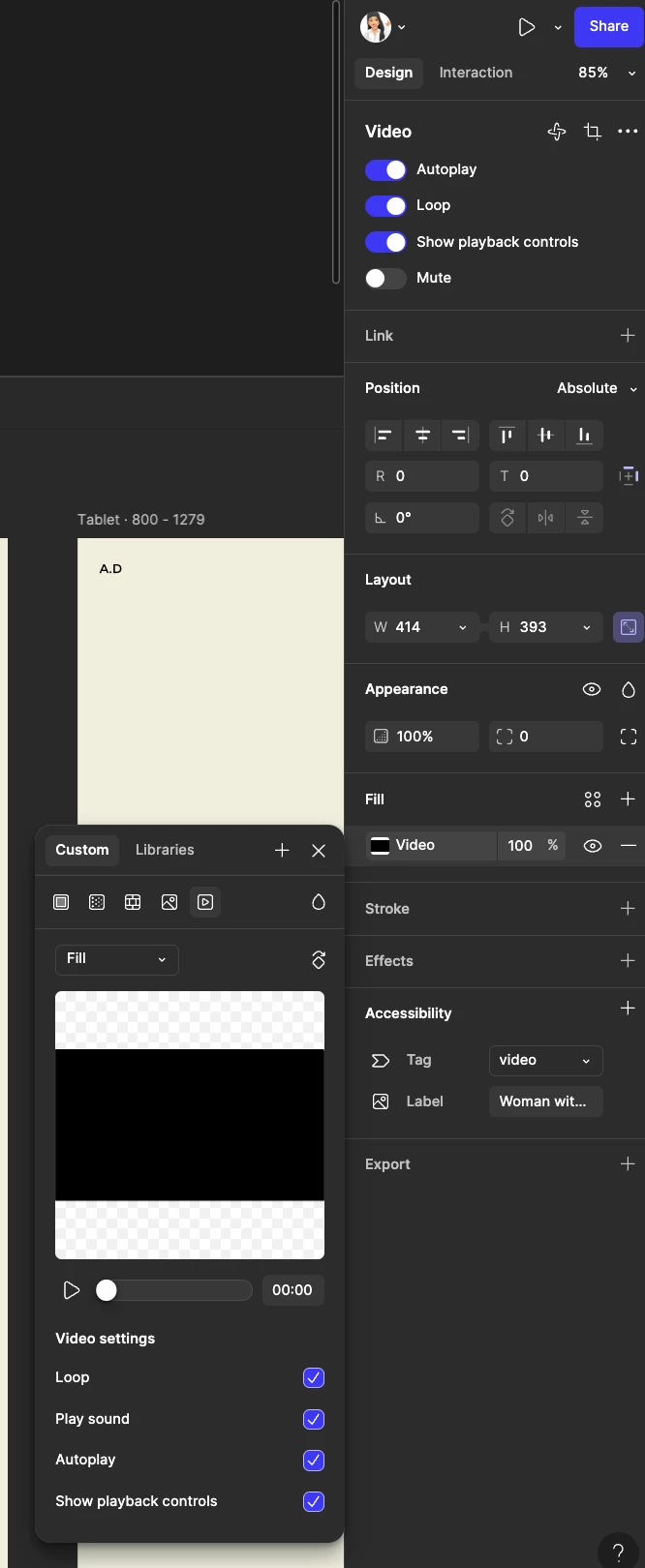

Hi everyone,
I recently noticed that Figma Sites now allows us to embed video directly into frames, as follow:
This looks like a really useful feature for adding richer content.
However, I am running into a problem:
  • The video displays and loops fine.
  • But the sound does not play at all, no matter what settings I choose.
  • I have tried enabling “Play Sound” and disabling “Mute,” but the video remains silent.
Has anyone else encountered this issue? Is there a workaround or a known limitation with Figma Sites’ video embed? Or could this be a bug in the current release?
Would really appreciate if anyone from the community (or the Figma team) could clarify whether sound on video embeds is officially supported yet.
Thanks in advance!

Apologies for the confusion earlier — the audio is present, but it doesn’t autoplay. I have to manually toggle the sound from the controller. What I want is for the video to play with audio automatically. This works in normal Figma Design, but not in Figma Sites.
If this isn’t possible, it makes the Play Sound / Mute / Unmute toggle pretty useless, since videos are always muted by default until the user manually enables sound from the controls.
Is there any workaround for this?
Sample for both products
Settings as follow
  • Play Sound = Checked
  • Auto Play = Checked
  • Mute = Unchecked
Problem:
  • In Figma Site, the video does not play audio automatically, even with these settings. The sound only starts after the user toggles it on from the playback controls.
Expectation:
  • In Figma Site, the video should autoplay with audio enabled by default, without requiring manual toggling.
Let me know if you see this problem

I checked with the team and confirmed that autoplaying video with sound isn't supported in Figma Sites. This isn't a bug with Figma Sites itself (major browsers like Chrome, Firefox, Safari, and Edge block autoplaying videos with sound by default for accessibility reasons.)
That said, we recognize that the current UI can be confusing (since enabling "Autoplay" effectively forces the video to be muted, those toggles should be connected). Our team will work on improving this so it's clearer in the product.
