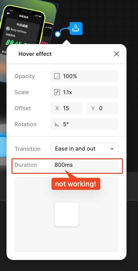

figma sites , hover effect - duration not working.
6 replies

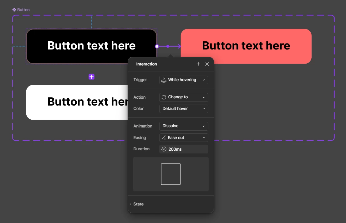

Wentils Lentils
Jul 27, 2026 2:58 AM UTC
Hey ​@adamsmasher, thanks for the reply. This is specific to Figma Sites.
Using the overlay method with varying opacity works as expected on something like an image, but my context is a button, where both background color and text color are meant to change on hover.
This same component setup utilizing dissolve works fine in FIgma Design, but not in Figma Sites. Switching the animation to Smart Animate gets halfway there, where the background fades in and out on hover, but the text color change remains instant. Let me know if that makes sense and if you have more questions.

Ok, I see what you mean, ​@Wentils Lentils. I replicated by doing the following:
  1. In Figma Design, I created a simple component with two states, and set up a hover interaction between the two where the background dissolves over 1000ms.
  2. I copied the base component state, then pasted that into Figma Sites.
  3. When I preview the prototype and hover over the component, the dissolve is instant.
I also saw this happen when publishing the Design file as a library, then inserting the component from the library rather than pasting. I’ll file a ticket with our engineering team regarding this - while I don’t know how quickly this might be resolved, that’ll get it in front our engineers so they are aware of the issue. Thanks again for posting about this, ​@Wentils Lentils and ​@Phily!
