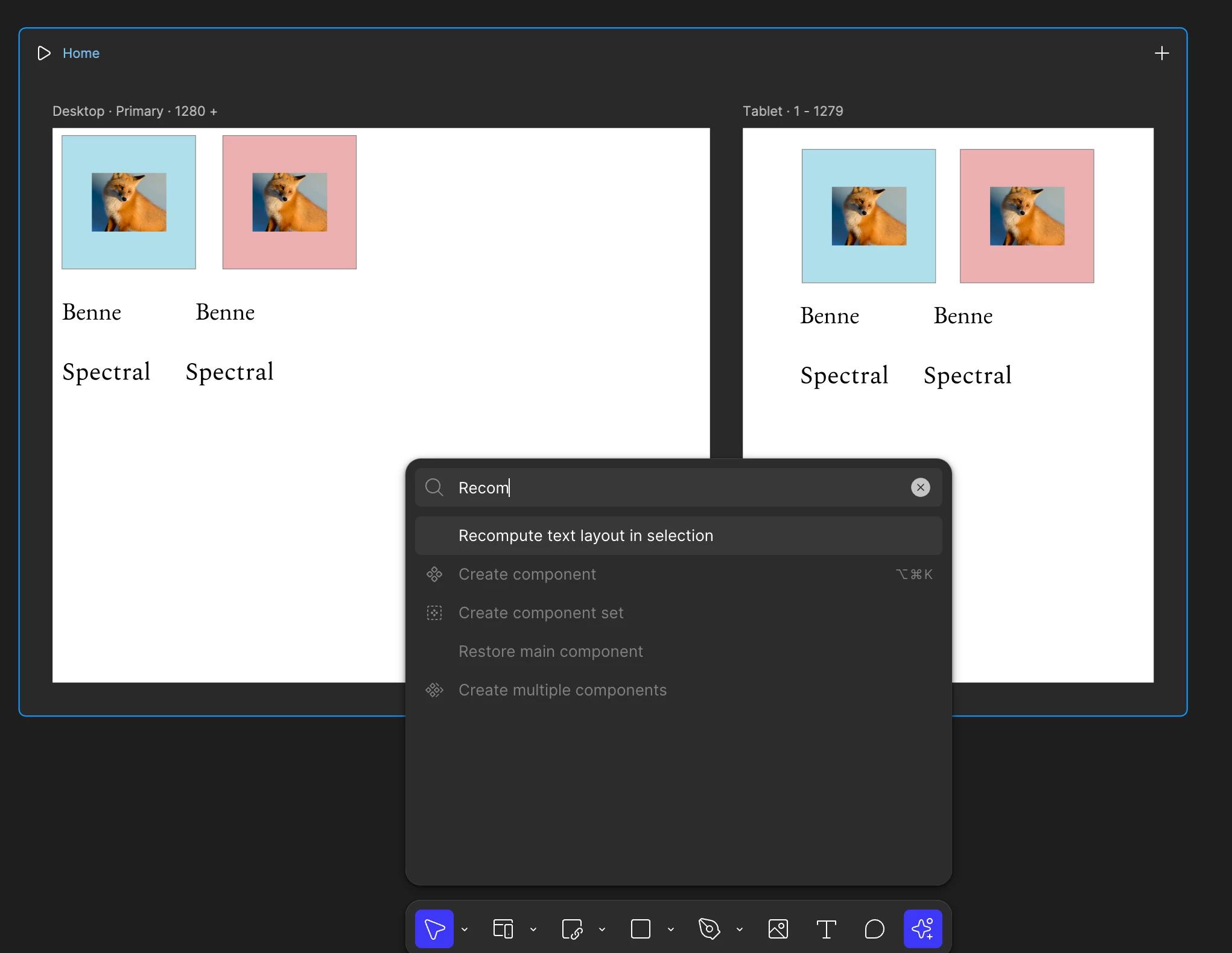

Hi ​@Manuel_Esposito
Thanks for bringing this issue to our attention. If you're experiencing this with Google Fonts, could you try using the "Recompute text layout in selection" option from the Actions menu? You can access this by pressing Command+K on Mac or Control+K on Windows.
If that doesn't resolve the problem, we'd appreciate if you could submit a formal bug report with detailed reproduction steps. You can do this here: https://help.figma.com/hc/en-us/articles/360041468234-Submit-a-bug-report
This will help our engineering team pinpoint exactly what's happening.
Thanks for your patience!
Toku
Manuel_Esposito
@y_toku Thank you for your reply. Unfortunately it didn’t make a difference. Instead it lead me to try to  reproduce the problem in different browsers.
Chrome: Fonts displayed not correctly
Brave: ( based on the Chromium web browser): Fonts displayed not correctly
Figma App: Fonts displayed not correctly
Figma App Beta: Fonts displayed not correctly
Safari: It works correctly! the fonts are displayed just right! 🤔
Maybe we get closer to find a solution. I will submit the bug and let you know.
Thank you
