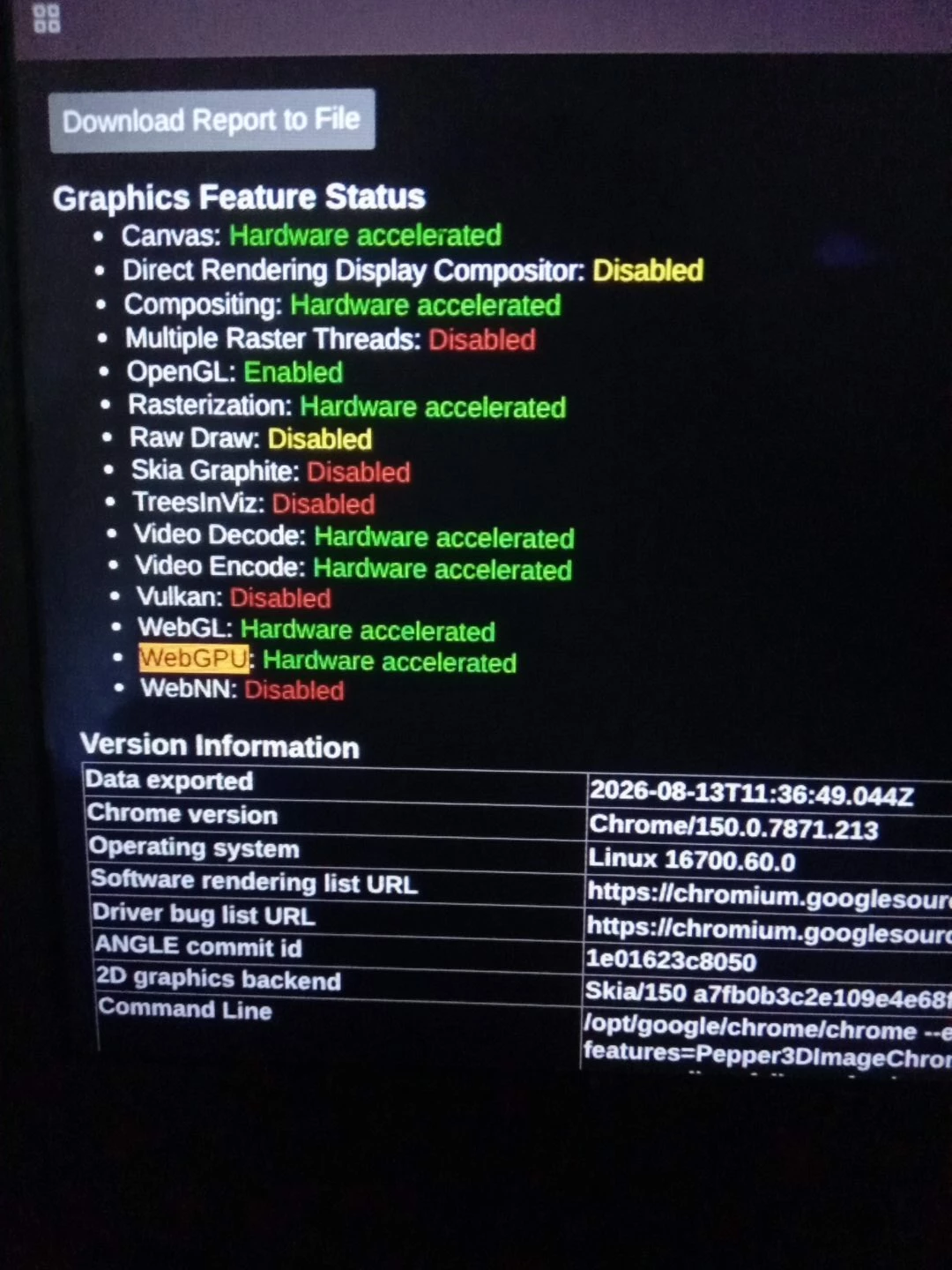

 for the suggestion. I checked chrome://gpu as you recommended.

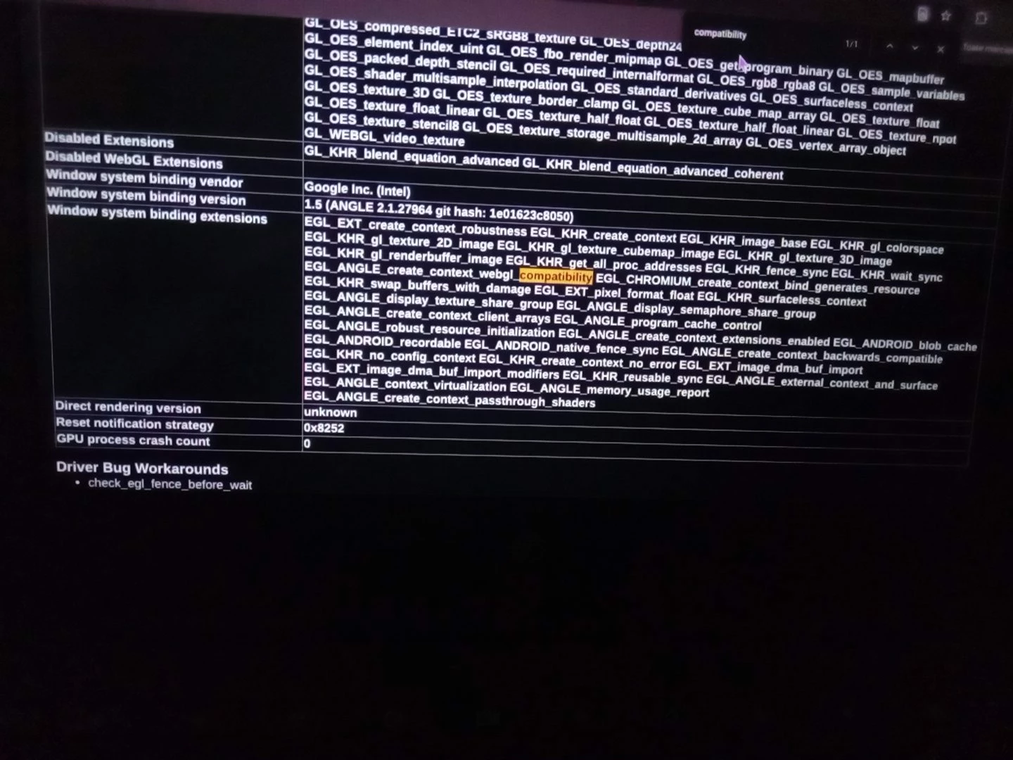

WebGPU is reported as “Hardware accelerated,” and I searched the page for “compatibility.” I couldn’t find any indication that WebGPU is running in compatibility mode. The only match I found was related to an EGL/ANGLE WebGL compatibility extension.

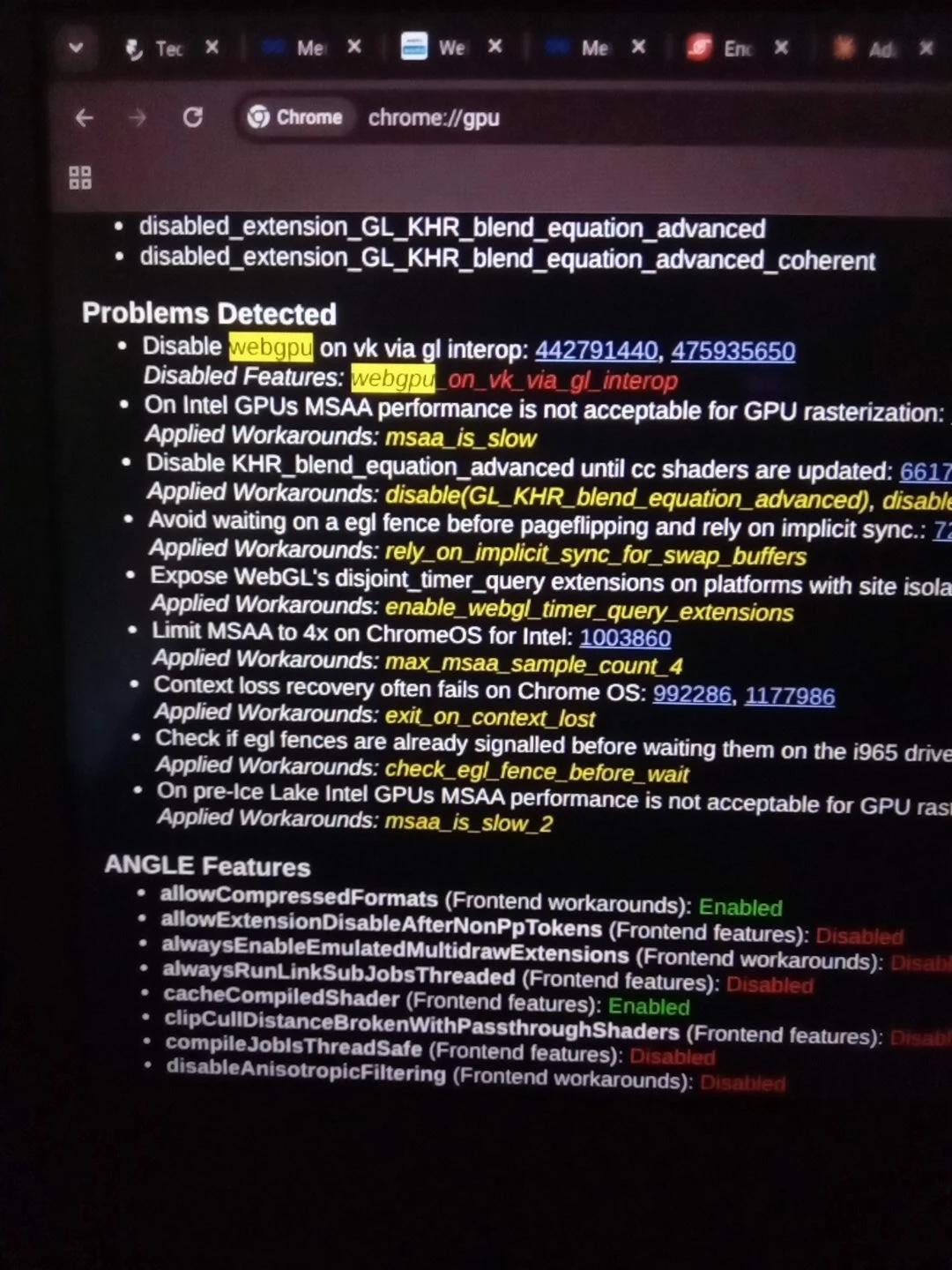

I also found this under “Problems Detected”:
“Disable WebGPU on VK via GL interop”
and under disabled features:
“webgpu_on_vk_via_gl_interop”
I’ve attached screenshots of these sections. Could you please let me know whether this disabled feature could be the reason shaders aren’t working on my Chromebook, or if there is another specific GPU line from chrome://gpu that you would like me to provide?

Hey there. Thanks for the screenshots. This is an issue on the Chrome-side of things and not something Figma has control over.
The longer more technical answer is: your device is hitting webgpu_on_vk_via_gl_interop, a Chrome blocklist entry (crbug 442791440). Note Vulkan: Disabled just above it. On your Intel Chromebook, WebGPU's only route to the GPU is the Vulkan-via-GL-interop path, and Chrome has that path switched off.
Without an official update from the Chrome team or finding an adapter here webgpureport.org there isn’t anything that Figma support can address with this Chrome-based blocker. I’ll share this as feedback with our team. Best — Jaycee
