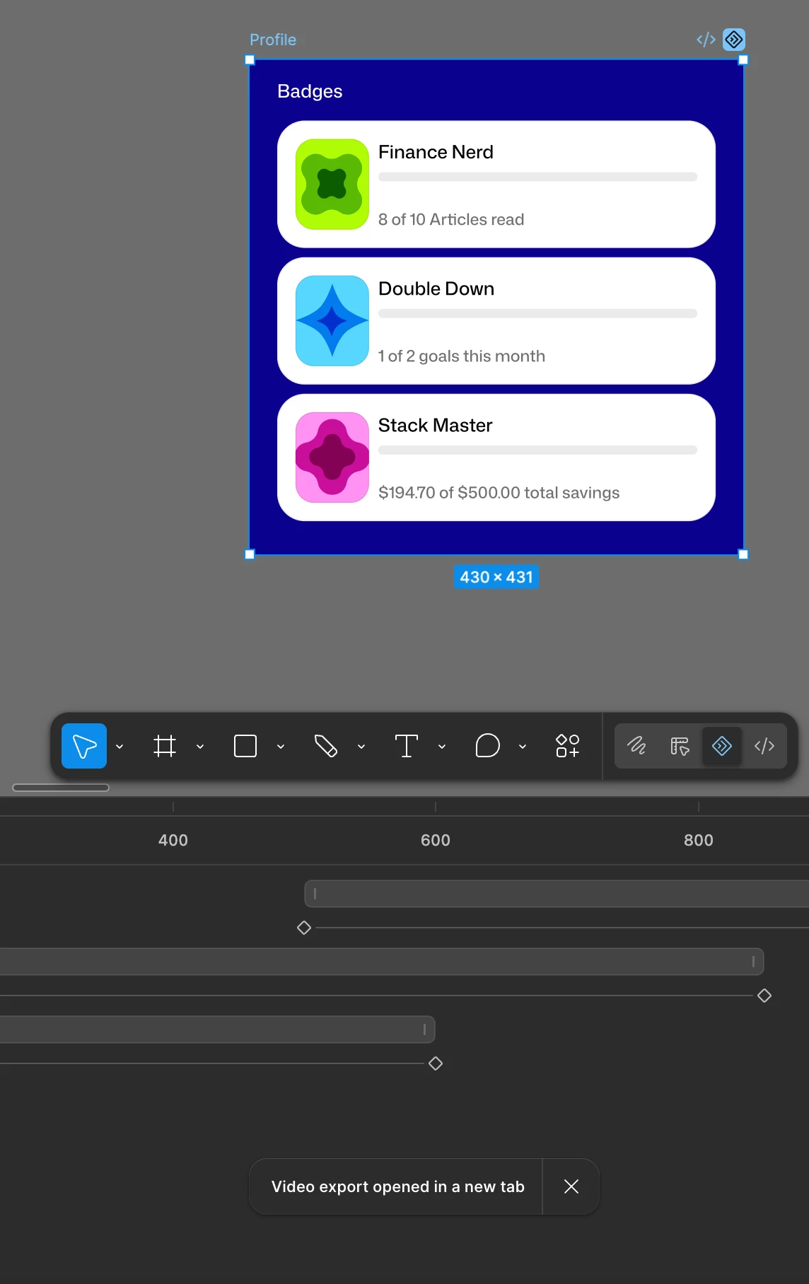

I'm trying to export an animated frame. I get a message saying the video export will open in a new tab, but no new tab opens, so I can't export the video file.

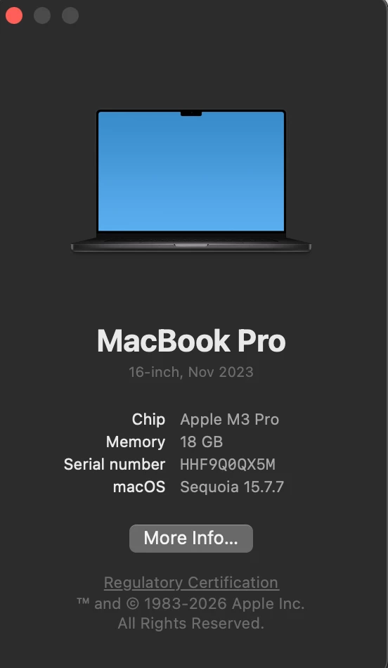

Info attached ​@Celyn_L ​@Jaycee Lewis
Figma Desktop App version 126.3.12

Hey all! FWIW, I was having the exact same issue as ​@jtreash : When trying to export .mp4, .gif, or .webm (basically anything but svg), I got the same error: a message saying “video export opened in a new tab”, but no tab ever appeared, and consequently, no video was ever exported.
However, per ​@David Hornsby ‘s advice above, I just updated my copy of Figma (current version: v126.6.12) and this seems to have fully resolved the issue! When I click Export, the new tab appears with the video, and a link to download the file.
