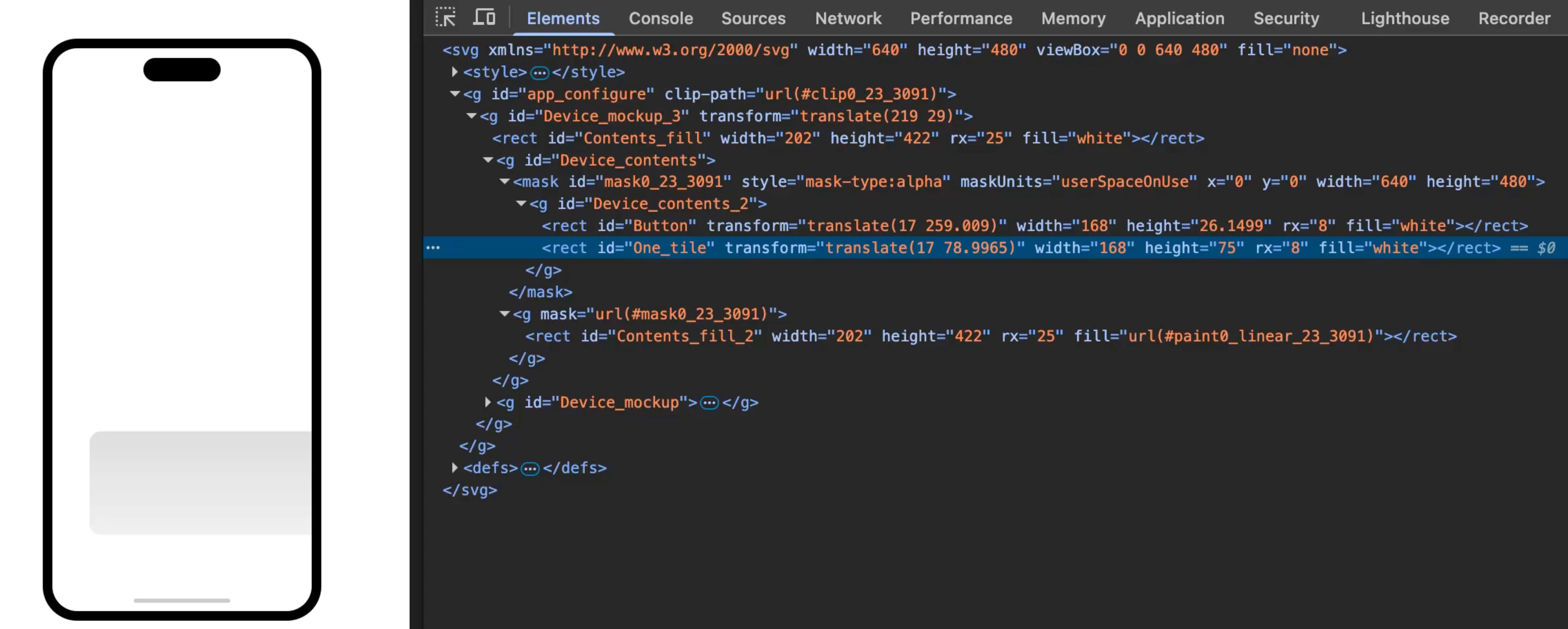

In my specific use case, there are two rectangles with rounded corners which move on top of a device frame mockup. The rectangles are part of a mask group (alpha), which adds a shared gradient as their fill. You can see below that the animation looks good in Figma, but when exported as animated SVG, the additional transform attribute shifts the larger rectangle, which breaks its appearance.

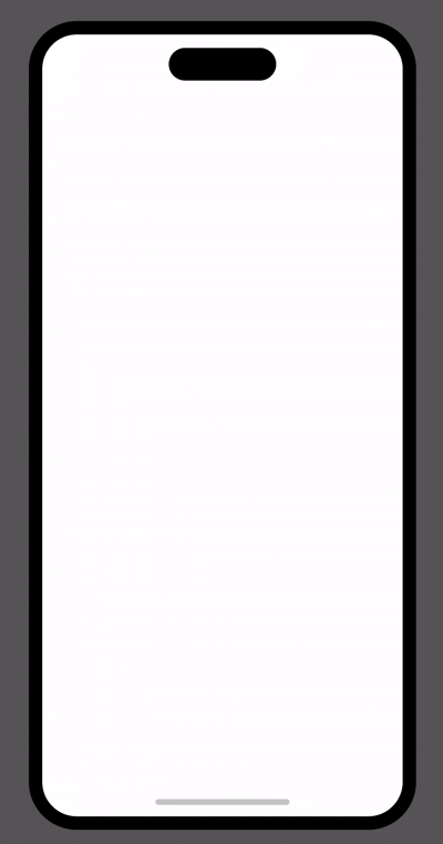

Original animation (viewed in Figma)
Exported SVG (viewed in Chrome)

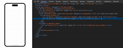

Exported SVG after removing the transform attribute value (viewed in Chrome)

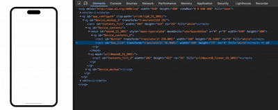

Higher resolution screenshot of the relevant parts of SVG code for this animation (before removal of the transform attribute).
