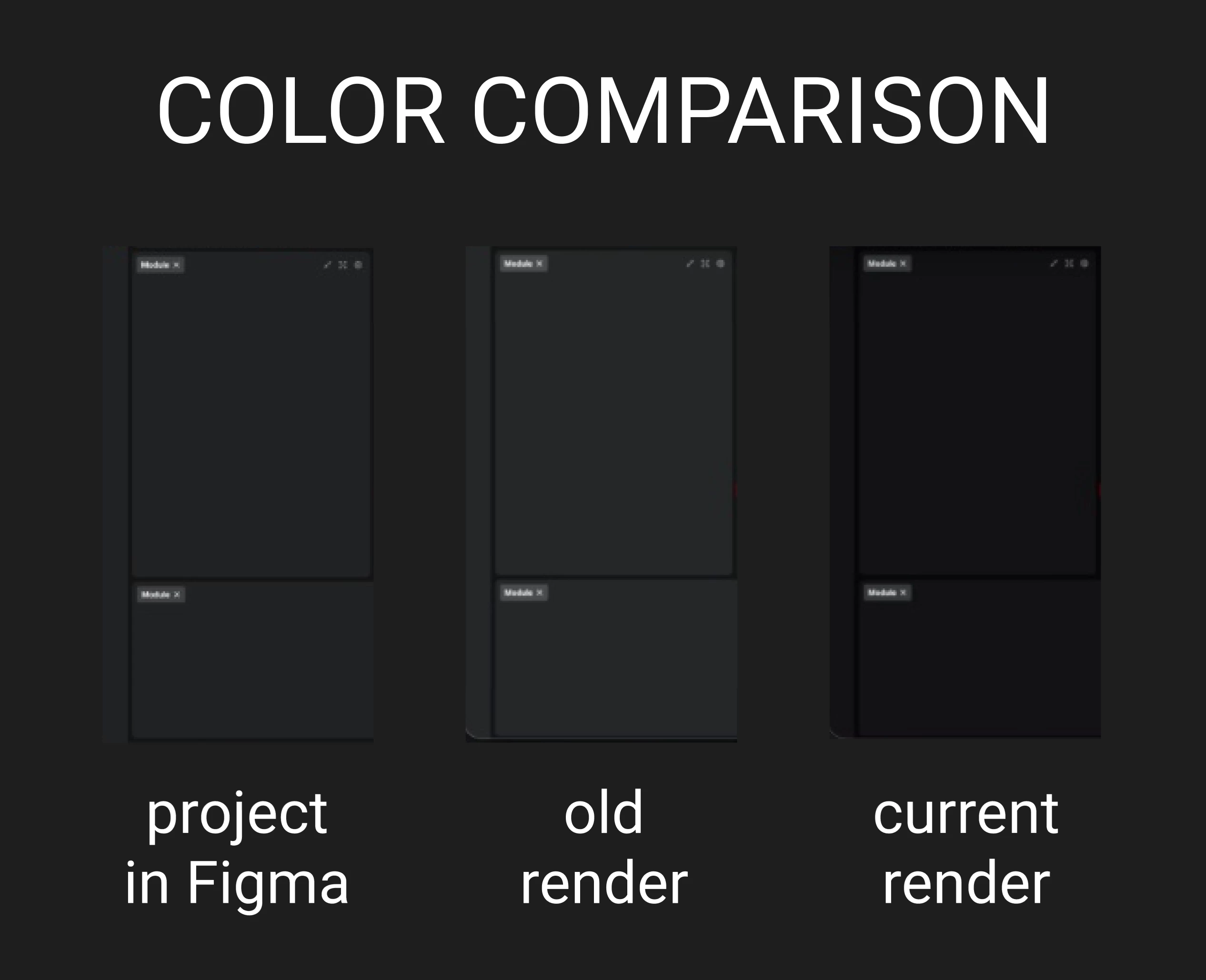

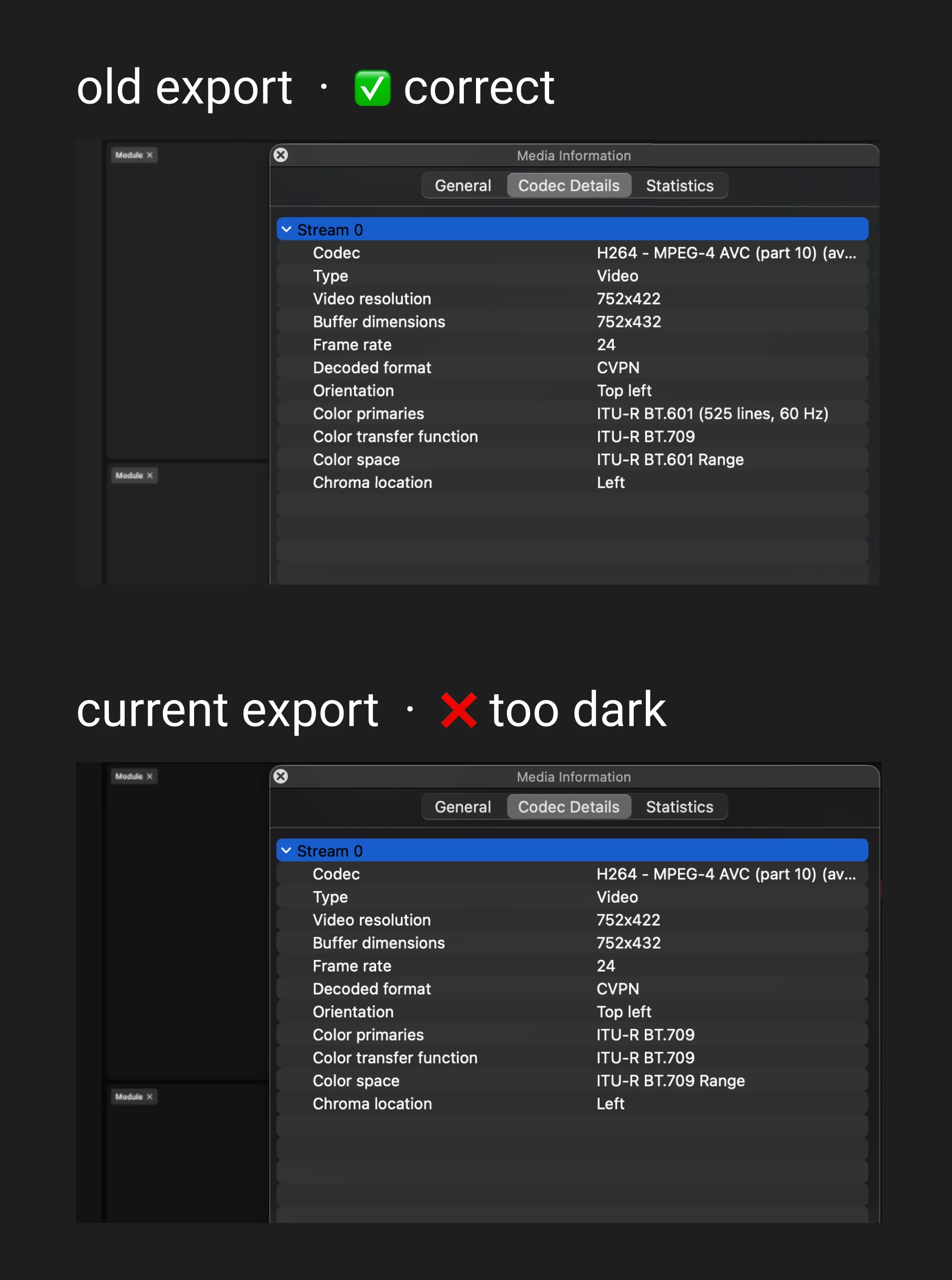

@Jaycee Lewis ​@djv I'm also experiencing the exact same issue with MP4 exports on macOS. An animation that exported perfectly a few weeks ago now renders drastically darker, despite using the exact same project and render settings.
I compared the media files in VLC and found a clear change in the underlying color matrix used by the encoder:
  • Old (Correct) Render: Encoded using ITU-R BT.601
  • New (Bugged) Render: Encoded using ITU-R BT.709
I'm attaching screenshots comparing the original canvas, the old vs. new renders, and the VLC codec data to help illustrate this.
Hope this helps the engineering team pinpoint the exact regression!
