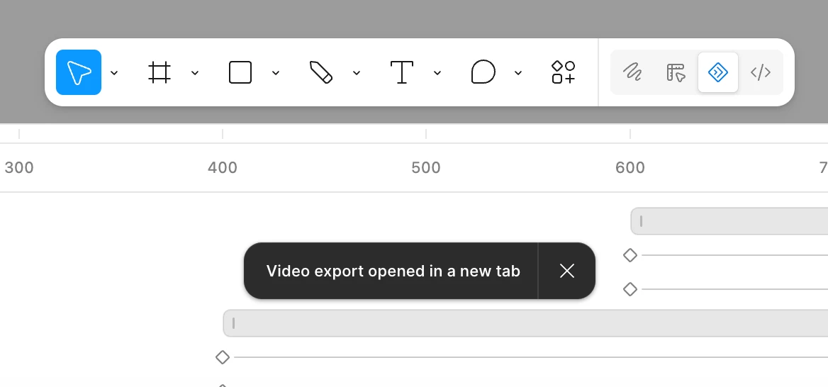

​@alnana  ​@adamsmasher I’m also having issues exporting mp4 and webm, I get this message but nothing actually gets exported

Any answers? Same issues and it’s not intuitive where this “new tab” should be opening.

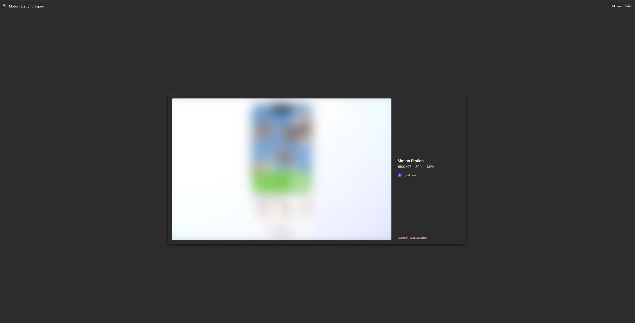

Screenshot of what I'm seeing.

I'm experiencing the issue on web browser. I have not yet tried the next top app. The dimensions are not larger than the one stated and I'm trying to export in in 30 frames per second. Any assistance will be appreciated. Thank you

​@alnana from what I can see about your issue you ARE seeing the export tab, so thats good, but there’s something preventing your machine from actually creating frames of video. The first ~10% of the export is us loading the Figma file again in the new tab and making sure we have access to all of the assets/images things we need to start making video, from that point we actually start making the video. I couldn’t find the file in the support-share@figma.com account did you manage to share it? I’ve requested access to your file so I can take a look to see if theres something in it thats preventing the export.
