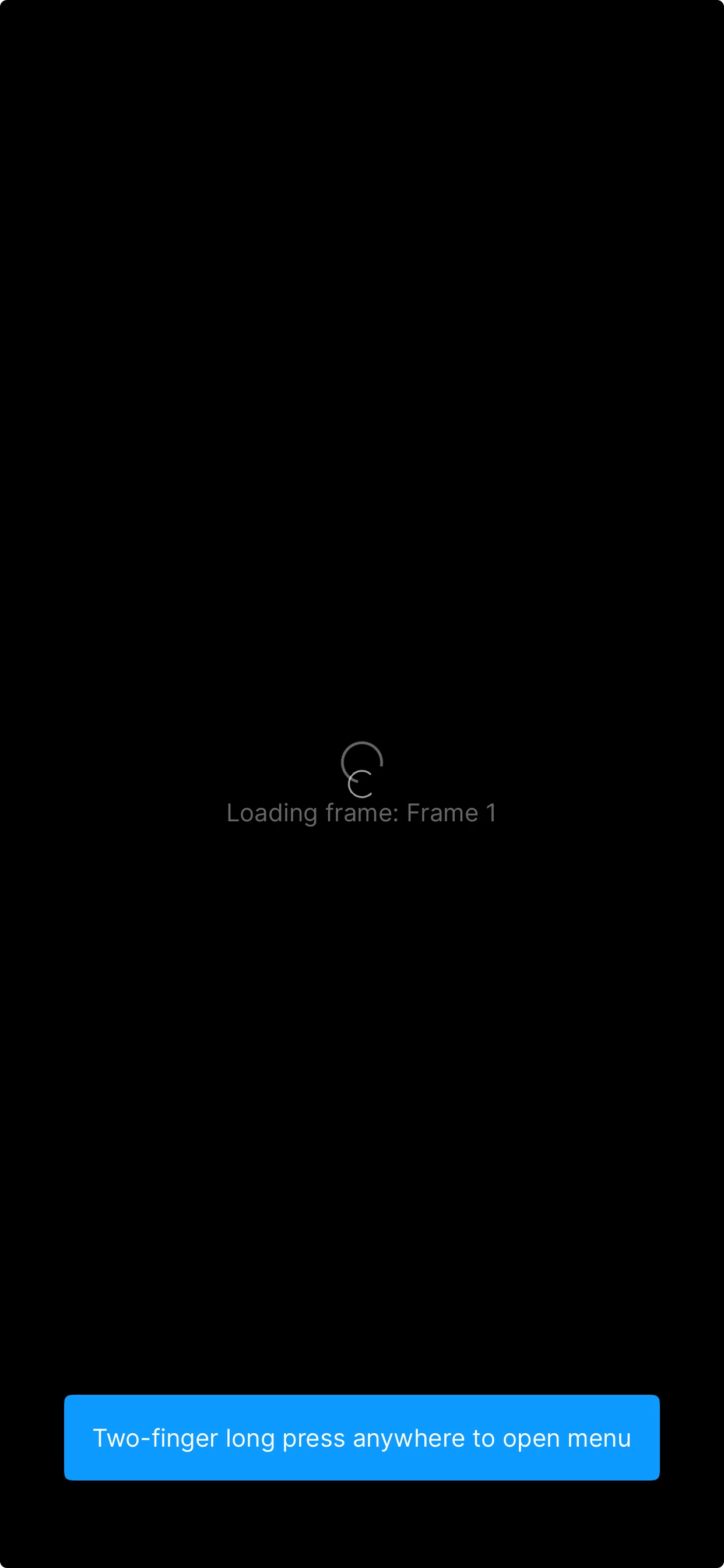

Hello,
Figma Mirror hasn't been working for few days on my iPhone.

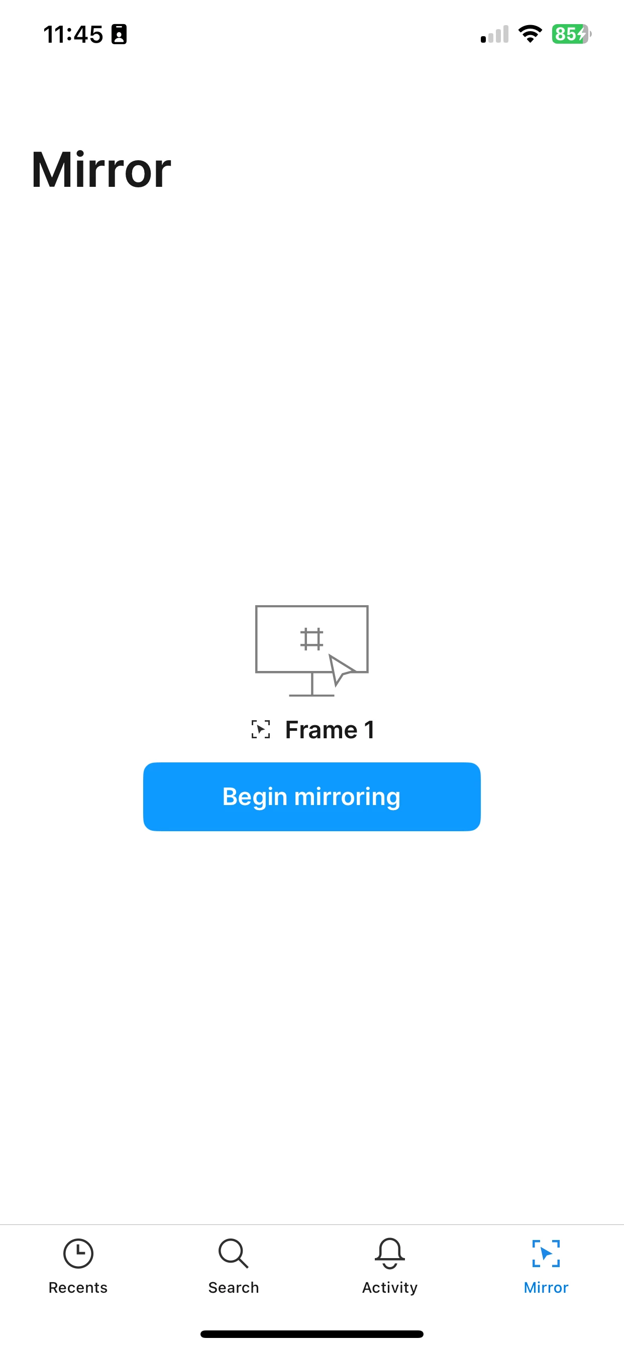

It used to work “ok” before but now, every time I want to use Mirror, I just see a black screen no matter what I try. The app correctly shows the selected frame prior to mirroring but as soon as I tap on “Begin mirroring”, I see nothing but a black screen.
  • I tried with different projects...
  • I restarted Figma on macOS...
  • I rebooted my Mac...
  • I restarted Figma on iOS…
  • I rebooted my iPhone…
  • I logged out/logged in again on macOS and iOS…

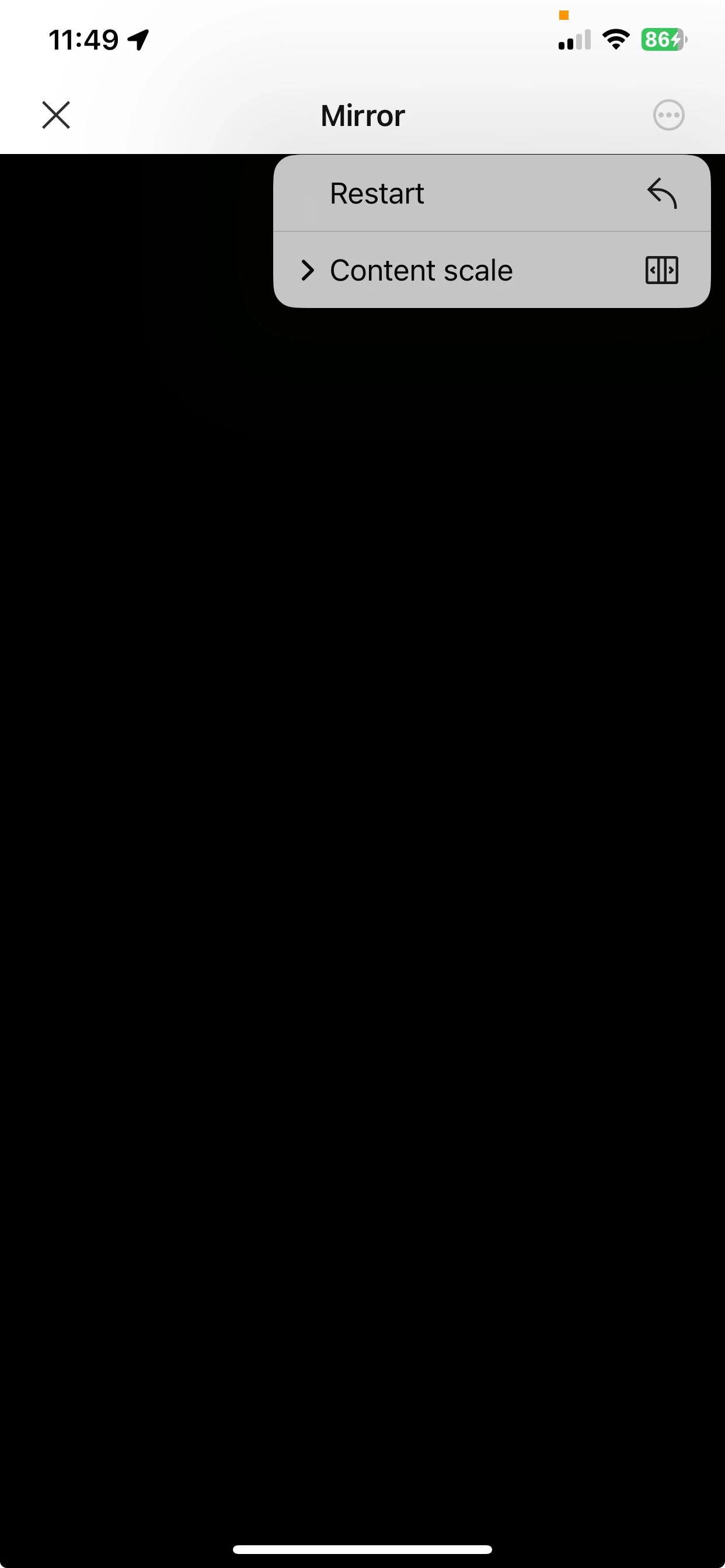

  • I “restarted” the preview from the iOS app
Just a black screen.
Can you help please?
Thank you,
Axel
