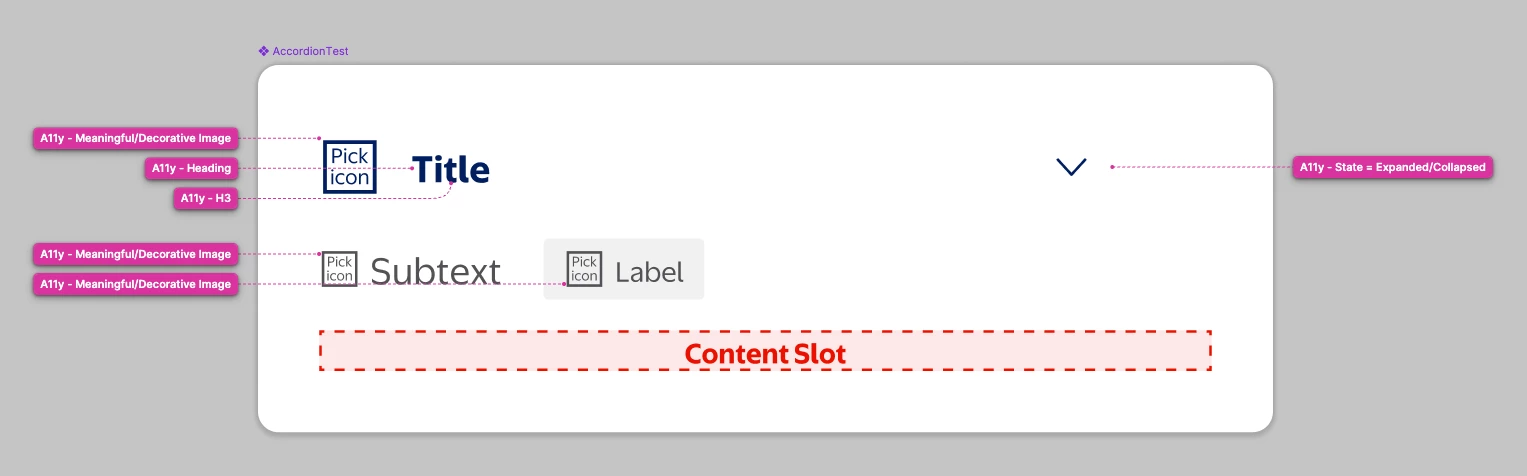

I am experiencing the same issue. When I add annotations to a component, they are not showing up when running in agent mode on VS Code for eng’s to see. I had watched the recent ‘Release Notes’ video for July 2025 saying that this was a feature release that was now available. Is there any update on this by chance. Have run Figma MCP in various trials asking it it in prompts and .md files but still no luck. Thanks for any insight! Much appreciated! (Attaching annotation image and prompt)
Generate my Figma selection in 'React Native' code and be sure to include annotations from the selection, get_variable_defs, create_design_system_rules and analyze the README.md file for instructions. Figma selection: https://www.figma.com/design/...
