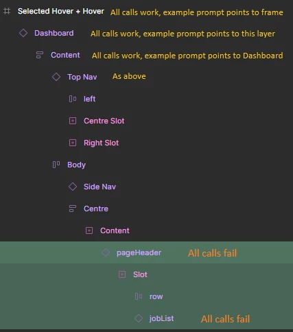

The document I’m working with is reasonably complex, with multiple sections, frames within them, and hierarchies of instance layers. The get_metadata, get_screenshot and get_design_contexts calls at the frame level generally do work.
However, we’re mapping these through to our own web component library/design system, and often they don’t map cleanly and our frames can be quite similar, and so I’d like to be able to fetch the information for a specific component at a lower level of the layer hierarchy to carry out targeted work on that specific element - in this instance, jobList.

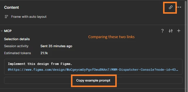

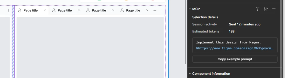

Here’s an example I tried this morning:
I also see that the direct link above the example prompt stops working from the first “Content” layer above, and gives a different link.
Example:
Here, the example prompt links to the “Dashboard” layer:
https://www.figma.com/design/x/x?node-id=4393-257150&m=dev
The link directly to the element (above the example prompt) gives a different URL, for which all calls fail:
https://www.figma.com/design/x/x?node-id=5178-9458&m=dev
However, at the lower level shown in the first screenshot, pageHeader containing jobList, for example, both the example prompt and the direct link point to the same place, where all three MCP calls fail.
Both links now return the same:
https://www.figma.com/design/x/x?node-id=5178-9526&m=dev
@https://www.figma.com/design/x/x?node-id=5178-9526&m=dev
Am I missing something, and these calls are only supposed to work at the frame level? Is it a problem in our document structure? There have been no changes to this file section for two weeks.
