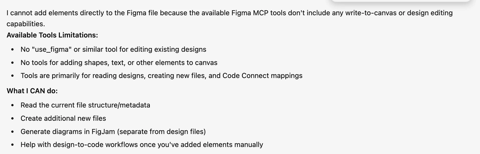

What doesn't work:
The write-to-canvas tool use_figma (the main tool for creating frames, components, auto-layout, and modifying designs directly on the Figma canvas) is not appearing in the available tools list.
The Figma MCP catalog explicitly lists Windsurf as supporting Read and Write access for Figma Design files. However, in practice, only read + Code Connect tools are loaded.

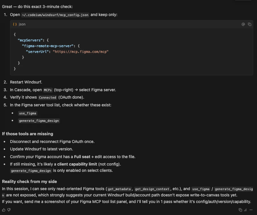

Hey there, I am facing the same problem. I tried all the following steps that AI suggested, but it is still not working.
