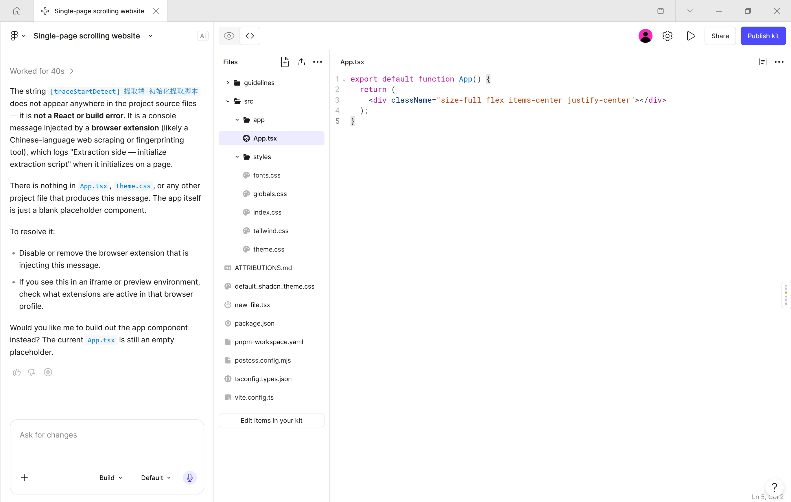

Figma Make Project Stuck in Kit Mode and Data Loss after accidental click
I accidentally clicked "Create a new kit" in my Figma Make project. Now the file is completely stuck in Kit mode. The original Make UI flashes for a split second before being forced into the Kit interface. The "Publish" button has changed to "Publish kit".
I tried to restore via Version History, but the preview fails to render because the renderer is stuck in Kit mode.
The original content is extremely important. Please help restore the file to its state before​ the "Create a new kit" action.

Hi, ​@dyx! Thanks for your post. Sounds like a confusing experience for you!
This was a brand new file that you chose the Create a Kit option, right? You can only create a kit from a brand new file, and once you’ve done that it isn’t possible to convert it to something else (after your initial prompt, the option will no longer show in your file settings). You could use your kit with a new Make file so any work you made there is available for a regular Make file. To do this, open a new Make file, then in the prompter click Select a Make kit. Choose your kit from the list, then prompt Make to build from that.
Let me know if you saw something different from this and we’ll go from there. Also, ​@anniewarner is correct if you somehow did convert an existing Make project into a kit - we’ll need to take that to our Technical Quality team for investigation.

In other words, after clicking "Create New Kit" in the settings icon at the top right (just like I did), is it impossible or very difficult to recover the project?
adamsmasher
Aug 19, 2026 5:37 PM UTC
Right, you can convert to a kit but not back, which is why we only present the option with a brand new Make file so you don’t accidentally convert an existing project. Did you try using your Make kit with a new Make file? That should let you bring all the work you have in you kit into a regular Make project where you can use it to build out your app. You can ask Make to specifically use components and styles from the kit in the app. Let me know if you see something weird or have trouble doing that, though!
