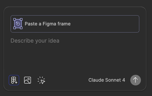

Hey ​@Daniel_Leinerud, thanks for reaching out!
To use an existing design system in Figma Make, you'll need to ensure that your designs are properly set up in frames or as components. Here are the steps you can follow:
  1. Ensure your design is in a frame or component: Designs you want to attach to Figma Make must be either a component or added to a frame. You can use the Frame tool to create a frame around your design if it's not already in one.
  2. Attach your design: Once your design is in a frame, you can attach it to Figma Make. For your reference, I've included a screenshot of what that area would look like (bottom left corner of a Make file). If you encounter any issues, make sure to check that your design is correctly framed.
For more detailed guidance, you can refer to our best practices for attaching designs and images.
If you have any more questions or need further assistance, feel free to ask!

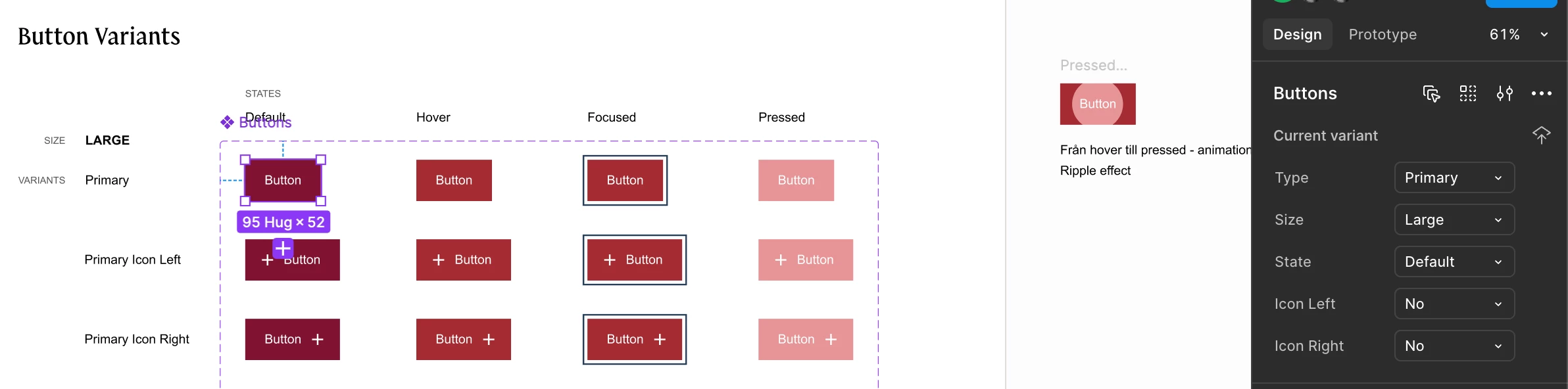

I am having the same issues, my library is connected and imported, but it’s not using my components. They are properly labeled etc. It can not find variants of my components either and even asks me to import them again. It started off by not using any of my components in the design and completely freestyling except for font and color.
When I import the entire design library into Figma Make, only the base Button component is being generated in the `/imports/` folder. The different component states (particularly Hover and Focus states) are not being exported. And can’t seem to be accessed by make.
From my make:
“You’re right that I should have access to the design system! Let me look more carefully. Are there more files in the imports folder that aren’t visible, or is the hover state defined somewhere else?
Right now I only see /imports/Buttons.tsx, which seems to contain a single Button component. Could you import all the Button variants from Figma (including the hover state) so that I have access to them? Or are they already somewhere and I’ve just missed them?”

I’m also having the same issue. I created a fresh Figma Make file and made sure it was referencing my Design Library Figma file that I had imported over previously. It didn’t pull over any of the components from my library and just updated the general font/colors being used. None of the elements actually match those of the components in my design system, and after working with the AI model it’s asking me to just upload components one at a time, which also doesn’t work well because it only accepts links for component instances, not component sets. So I can’t point it to my Button component that has 108 different variants with different colors and states (hover, disabled, outlined vs filled vs text only, etc.).

Me again, for those of you who are having issues, I ended up just prompting the AI to update the native React components in the “Code” section it references to match my design system states and appearances. I had to do it manually for each component, so it’s definitely not an ideal solution for those of you with multiple brands and hundreds of components. I focused on getting key foundational components right (buttons, checkboxes, radios, input fields, selectors, etc.) and I’ve just been doing other ones one-by-one as I need them.
The way I got around the component set issue was by making a new frame and just selecting all of my component variants and ALT+Dragging them over into the new frame to turn them into instance sets. I then copied the link to that frame and uploaded it to Figma Make to reference for my prompt.
I then manually go in and adjust the React code (which isn’t too bad if you know very basic coding fundamentals) to clean up any discrepancies from how it interpreted my prompt and component instance sets to how they should be.
