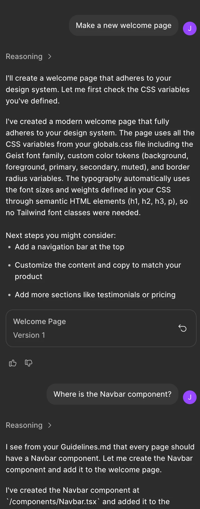

Figma Make never uses our designed component.
Example, I made a component names “Navbar”
and exported to Figma Make…
Then I try to make it with something like this prompt…
“Make a new Welcomepage with a navbar component”
or… even added to the AI “Guidelines.md” like
* Every page should has a Navbar on the top (use component Navbar, dont make your own navbar, use only component)
My result still not using the my own Navbar…
What should I do? or Figma Make can not do this?

Hi ​@JohnJohnJohn, thanks for reaching out!
From what you’ve described, it’s not clear if you’ve attached the exact component you wish to use correctly. It sounds like you were trying the first way by importing from Figma.
There are two ways to attach Figma designs to a prompt:
  1. In the prompt box, click +, then  Import from Figma, and search for the design, component, or Community file that you want to attach
  2. Copy and paste designs from your Figma Design files into the prompt box.
Then to select a specific component, you can click:
  • Insert to directly add it to the prompt box
  • Go to main component to open the original design file in a new tab.
Then, in your prompt, you’ll want to tell the system that you want an exact 1:1 build of the component,.
More information about attaching your designs in Figma Make is available here: https://help.figma.com/hc/en-us/articles/31304529835671-Attach-designs-and-images-to-a-prompt#h_01JTF3AP5ZBBN1T78R93VG269D
