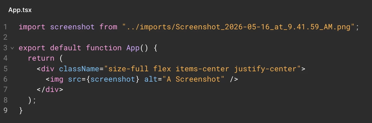

Interesting that this changed for you when it was consistently importing images correctly before that - I can see from what you’ve detailed how that would cause issues with the final output. What prompt or prompts do you use to add images to your Make app? I did a quick test with the following prompt:
Please import this image to the app homepage
And this was the result where it properly imported the image:
Properly imported image.

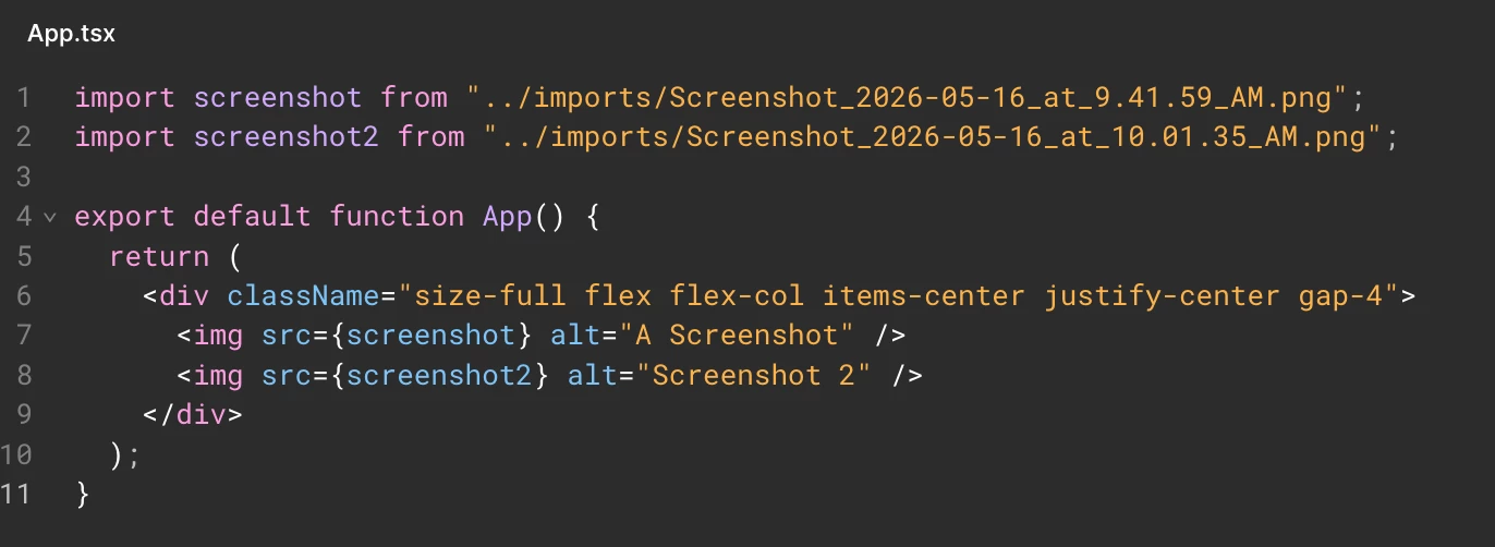

I then prompted it with this and a different attached image:
Please add this image to the homepage
This also gave me a properly imported image:
A second, properly imported image.
