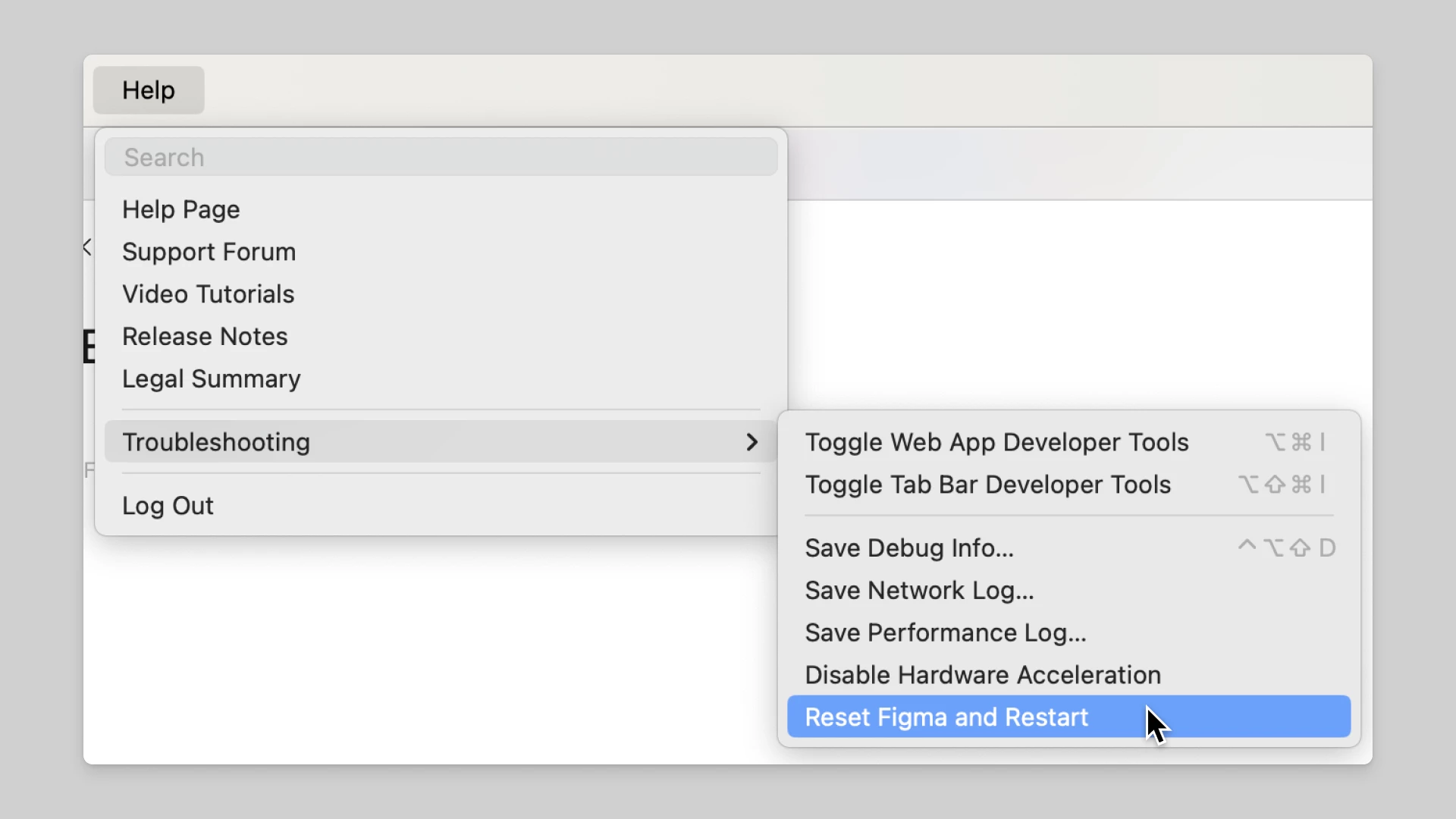

    On Mac:
    go to Figma menu → Help → Select ‘Troubleshooting > Reset Figma and Restart’.

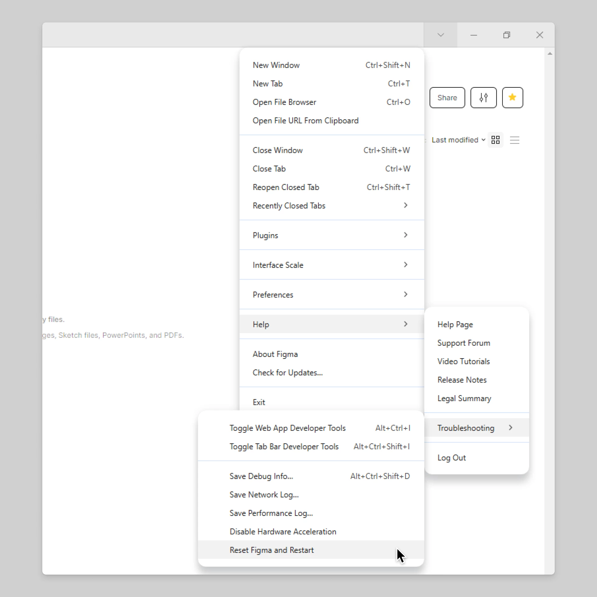

    On Windows: You can access the Help menu from the toolbar at the top of your screen.
    1. Click the  toggle arrow in the toolbar at the top right of your screen
    2. Go to Help > Troubleshooting > Reset Figma and Restart

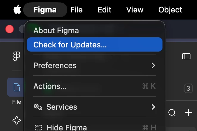

  3. Check for updates — to double check you're on the latest version of the desktop app
