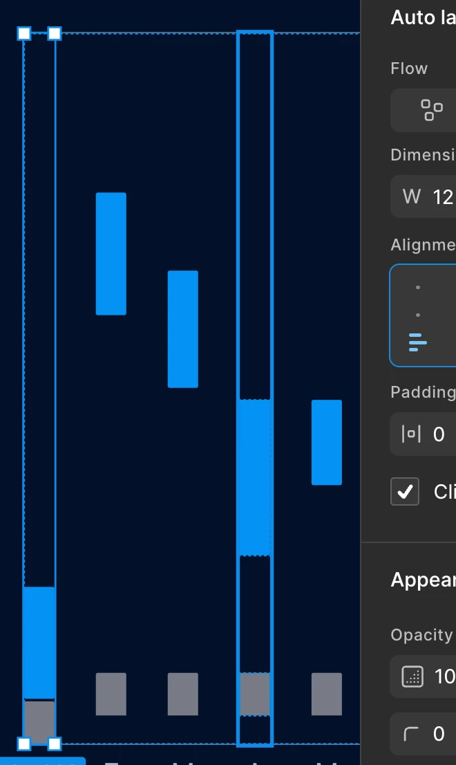

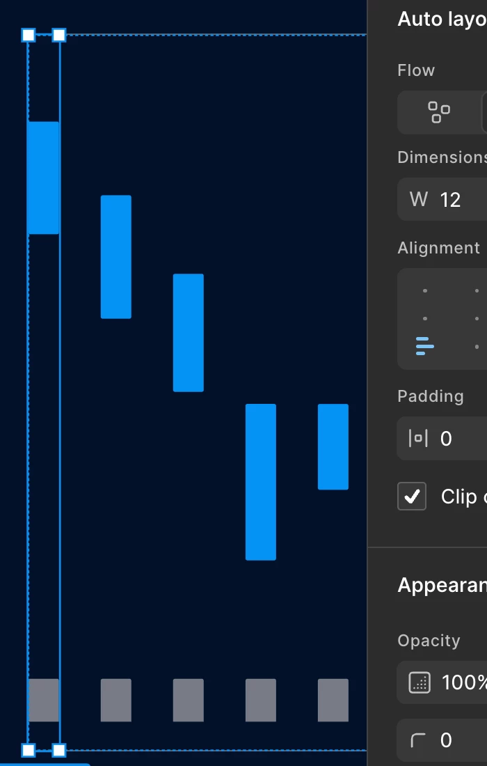

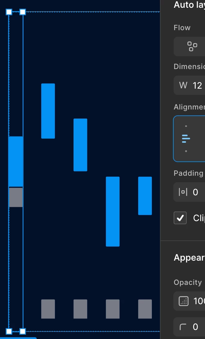

Richard Earney
Yeah there is some weird stuff happening at the moment.
I am creating some graphs, using a frame in a frame all are aligned to the bottom left. I come back to it the next day and they are all over the place.
I have to fix it by changing alignment and then changing it back

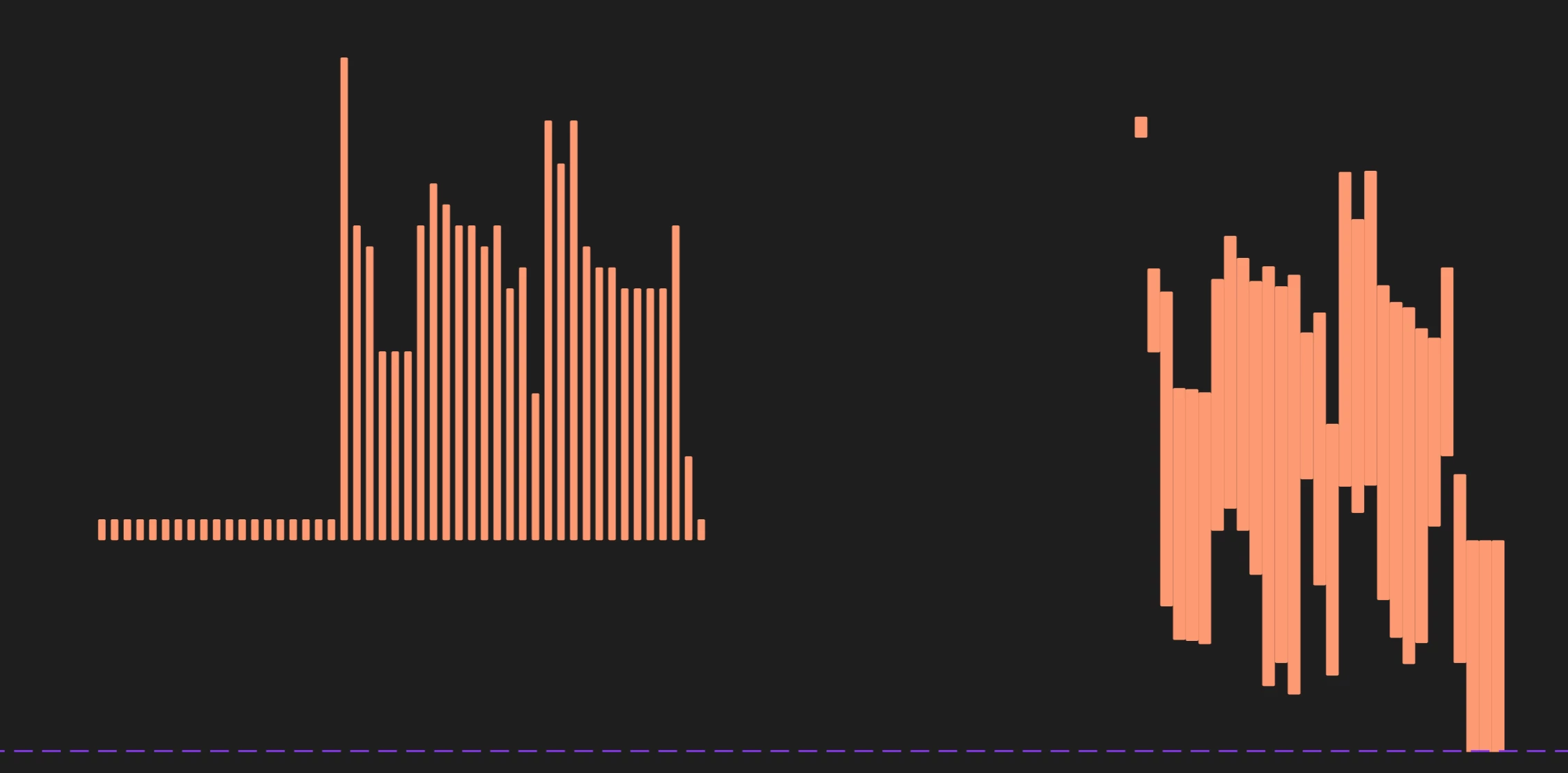

Richard Earney
@adamsmasher
After a few days of it being relatively well behaved, the heat has got to it again and a component that looked normal the other day has gone rogue.
It looked more like the left hand one yesterday evening, but this morning it’s as shown on the right
