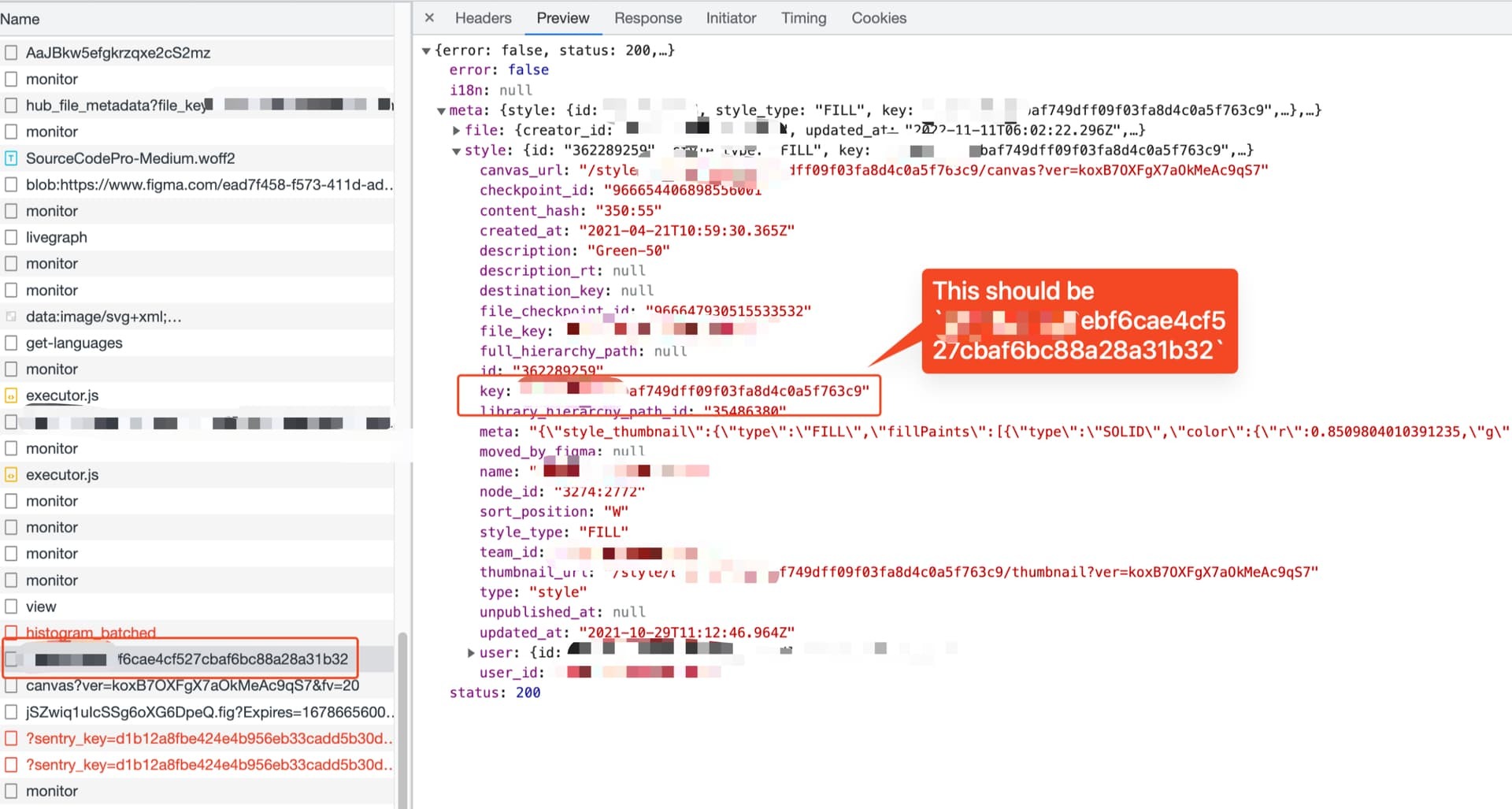

Mar 3, 2023 6:06 AM UTC
I’m facing same issue with this pluginAPI
 await figma.importStyleByKeyAsync(style.key)
After inspecting, the figma API respond with no error and successfully fetch the style, but the style key returned is different with the one requested. I assume the error happen on the client side.
Most of the styles can load correctly withawait figma.importStyleByKeyAsync(style.key), but only 50 of them in our library getting this error. Those impacted styles are created in 2021.
James_Yang
Mar 4, 2023 12:24 AM UTC
@Hao_Zhang So importStyleByKeyAsync throws an error for you for some styles, but the network request is succeeding? If you’re hard-coding the style keys some where, we recommend that you migrate to use the new keys returned by the network request.
The background here is that we’ve been making backend changes to the style key contents and so plugins using hard-coded keys obtained a while ago may end up using outdated keys.
@Sonny_Lazuardi_Hermawan Are you seeing the same behavior with the error being thrown but the network request to fetch the style succeeding? If so, I’d recommend using the info above to switch to using the new key from the network response.

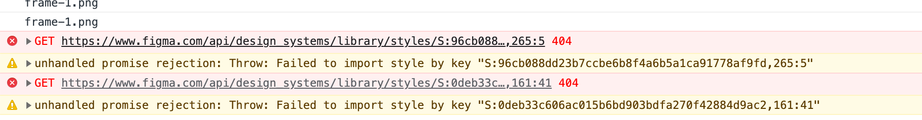

thomas_TikTok-Design-UX-APAC
Mar 6, 2023 12:53 PM UTC
hi, i have the same issue
Mar 6, 2023 1:00 PM UTC
i use restful api to get all styles from one lib file.Then i use figma.importStyleByKeyAsync to import all style key. On some file it looks fine.But in some files, this error occurs
