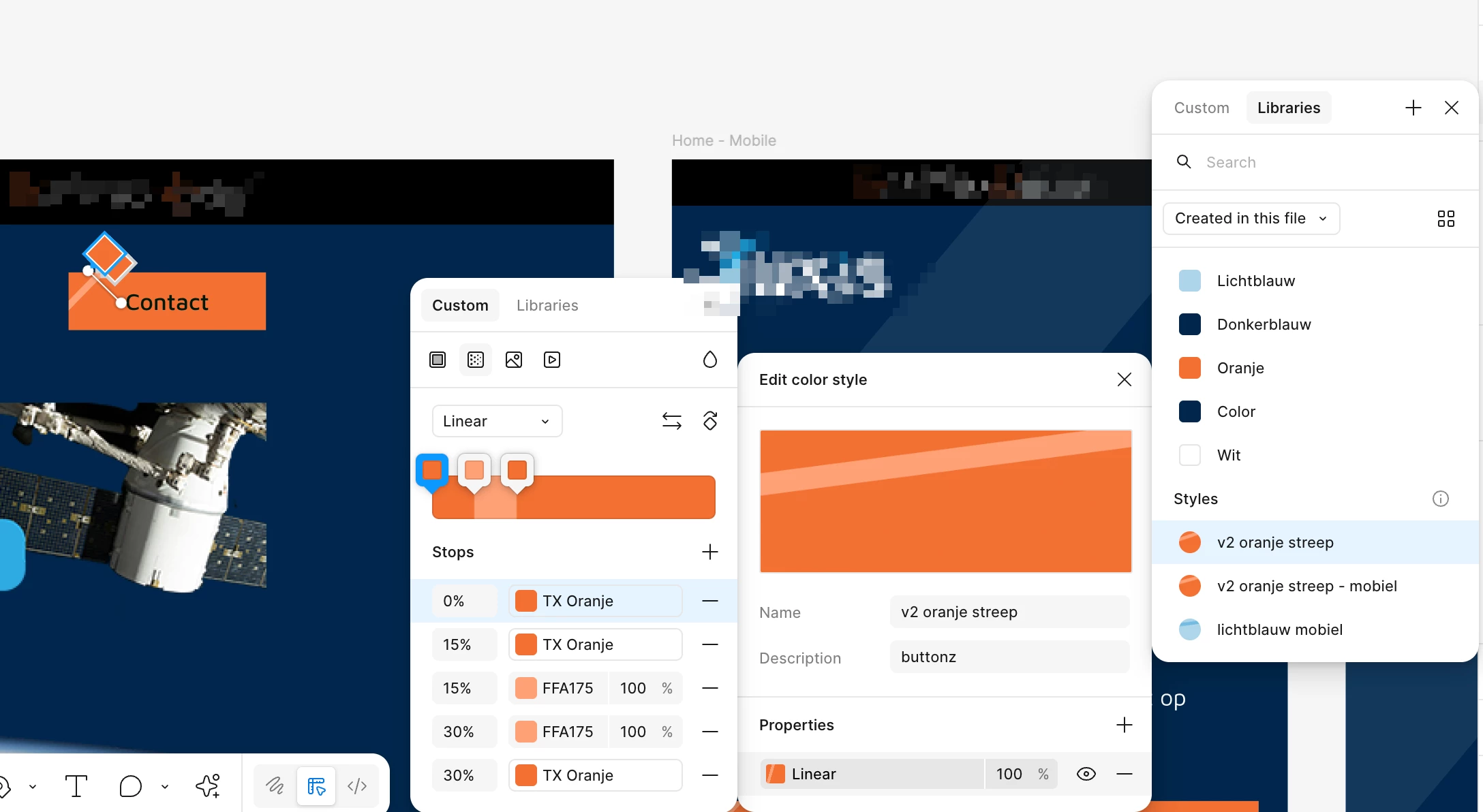

I have created a design with a gradient in a button:

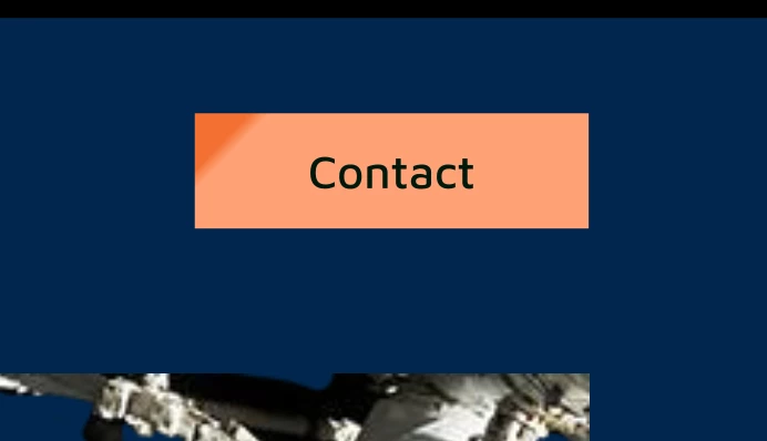

The PDF export however shows all buttons with a vage gradient not corresponding to the design I made:
JPG and PNG exports are working fine.

 I’m also sharing the details here for visibility, in case others run into the same issue. This is a bug we’re currently tracking, and our engineering team is actively investigating the root cause and working on a fix.

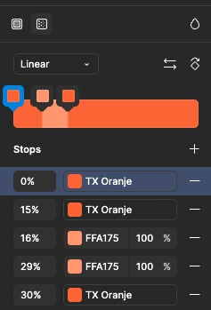

The issue is due to the gradient stop points overlapping in the linear gradient. For example, you have the TX Oranje at a 15% stop point and the FFA175 color starting at the 15% stop point. As a workaround, you can adjust your stop points so that they do not overlap and move them by just one value. This way, you can still achieve the same effect and export as a PDF.
