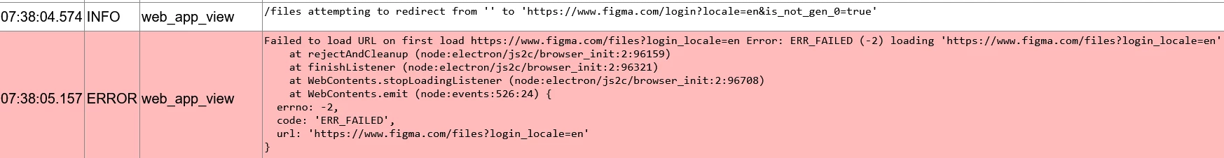

i have tried --dissable-gpu-sandbox in the properties. thats when even it opens. nothing happens if just open tha app. eventhough the task manager shows the app has launched. i tried switching off both of the gpus, and treid, disableing enabling vitualization options, sandboxing features, event disabling security feaure, uninstalling VPNs. nothing works..
the debug information i also added. this is the red flag from that

Hey ​@charaka amarasekara, welcome to Figma Forum and thanks for taking the time to troubleshoot this so thoroughly.
I had a look through the steps you tried with the AI Support Agent and I understand the Figma Desktop App shows a white screen as soon as it launches.
To help me narrow this down further, may I ask the following:
  1. You mentioned trying --disable-gpu-sandbox in the shortcut properties. Could you share the full text from the shortcut's Target field, and let me know what happens when you launch the app with it compared to without it?
  2. Can you install the latest version of the Figma Desktop App from figma.com/downloads and let me know if the behavior changes?
  3. Which version and build of Windows are you running?
  4. Roughly when did this start happening, and was it working as expected before then?
That will help me take a deeper dive. I'll keep watch for your reply. 🙏🏻
