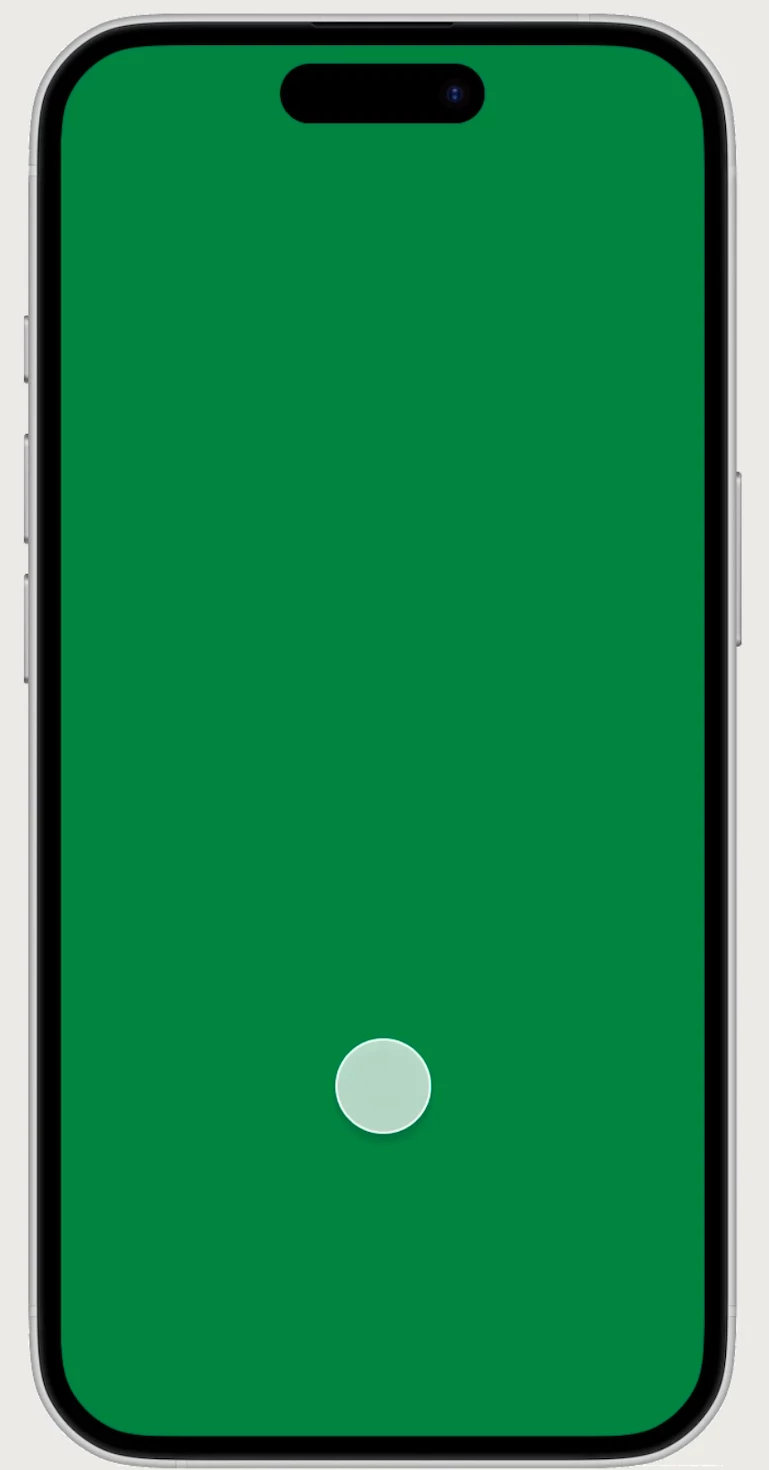

Figma cursor on prototype on desktop app is extremely big
Hi!,
My Figma cursor on the Mac desktop app is really big when I’m trying to play a prototype and interact with it. I was ideally looking to record a prototype, but the size of it looks terrible right now, especially over smaller UI components. How do I make it smaller or have it show up as a regular mouse?
Can you please help?

    Hey ​@FJunaid, thanks for sharing the screenshot!
    You could try switching the device and see if your regular cursor comes back.
    1. Click an empty part of the canvas to deselect everything.
    2. Open the Prototype tab in the right sidebar.
    3. Under Device, choose Custom Size (Fit) instead of a phone model.
    4. Click Present to play the prototype in presentation view, and record from there.
    Does the cursor look different after you switch to Custom Size (Fit)?
    You can read more about these options in Set prototype device and background settings.
    If switching the device doesn’t help, let me know and I’ll take a closer look.

    Hi,
    Thank you for your quick response! If I choose the custom size (fit), the cursor does get smaller, but I am trying to take a video prototype with the phone.
    From a design perspective, it’s not visually appealing to put a video prototype without a device on my portfolio. Is there another work around? Would really appreciate it.
