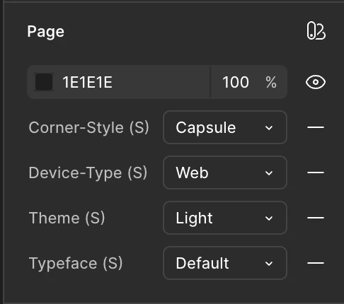

In my main design system, currently i have these 4 collection.

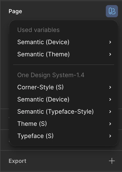

But after renaming a collection from 'Semantic (Device)' to 'Device-Type (S)' in the main design system file, now I can see both collection names in the working file.

Unfortunately, it appears that you’re experiencing a known, long-standing bug that our engineering team is aware of. However, we don’t yet have an estimated timeline for a resolution.
Currently, changing mode names or mode collection names doesn’t update in subscribed files. As a workaround, we suggest making a small change to the component that uses this variable — for example, adding a description to the component — then publishing the changes and accepting them in the subscribed file.
