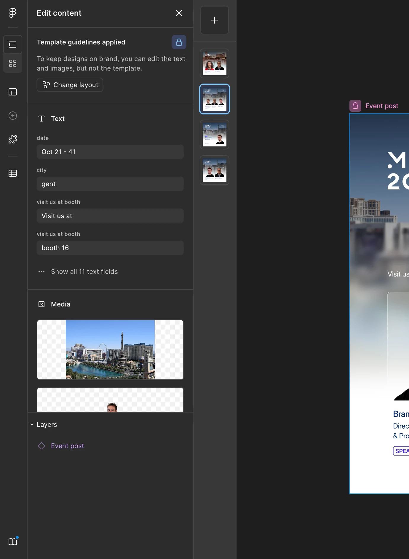

This is confusing to me, as I do sometimes still see the Edit content panel, it just seems to be at random whenever i see it, other times i just see the bulk edit screen, or nothing at all and have to rely on changing text directly in the canvas. (see image)

Hi ​@Straet and ​@Rodrigo C. As ​@djv mentioned, we appreciate the candor and feedback. To address the last comment in your reply, ​@Straet , Buzz actually is in an open Beta at the moment, though it seems like we might not be making that obvious enough.
Regarding your feedback on bulk editing versus “edit content”, you mentioned that this option seems to show up randomly. Do you think you could get a screenshot of the option when it does show up? Thanks!
