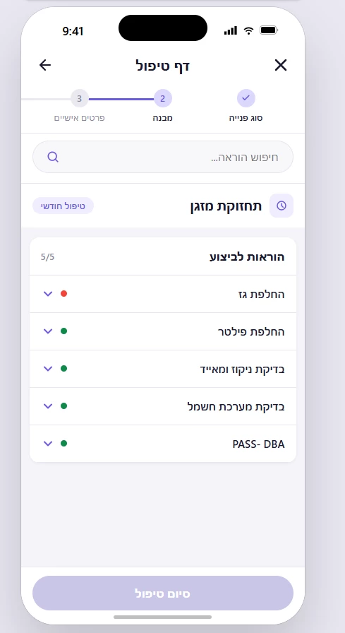

Has any else been having an issue with the Figma extension where ir copies the HTML screen and pastes it mirrored?
Does anyone have a workaround for this?
This is the original

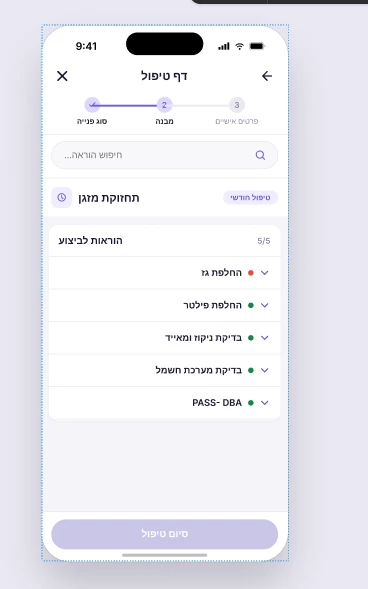

And this is how it was pasted in Figma:

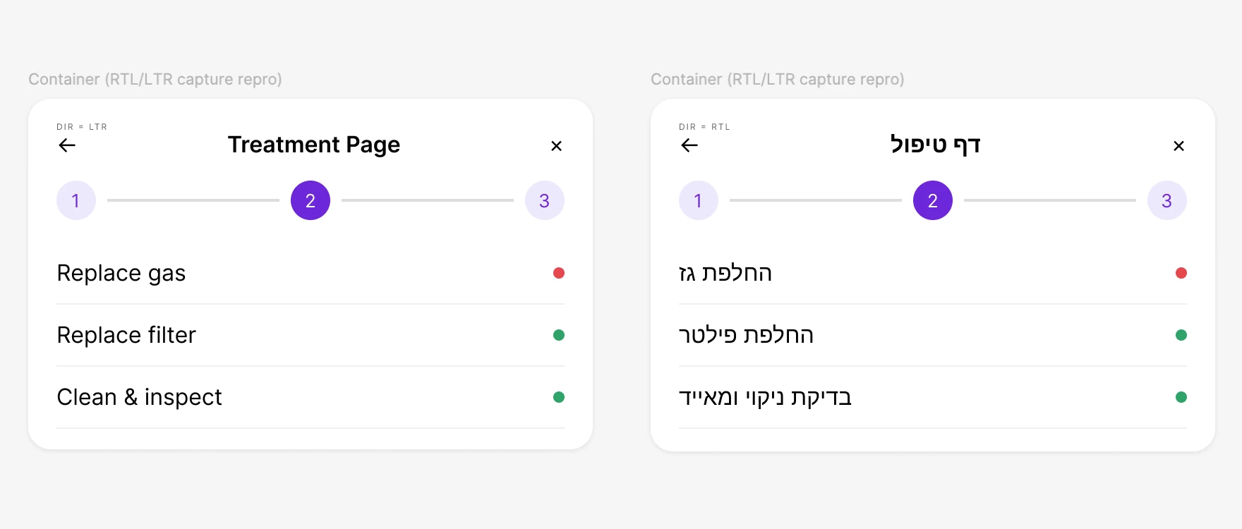

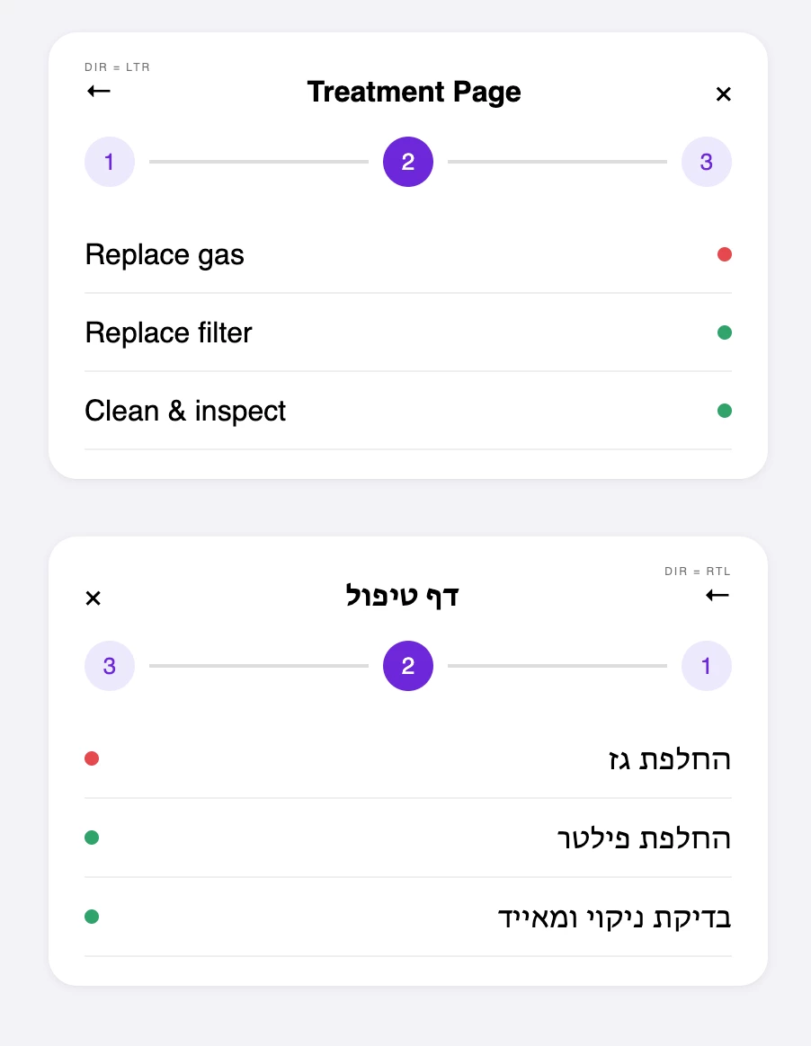

Hey hey ​@omer dayan 👋 Thank you so much for flagging this! I get the same result. I think whats happening is the dir="ltr" and dir="rtl" aren’t being carried over correctly. My quick test:
  • Created a simple static page using dir="ltr" and one dir="rtl"
  • Pasted both separately into a fresh Figma file
I took this to the team. I’ll post back here with any updates I get. We appreciate you! — Jaycee
