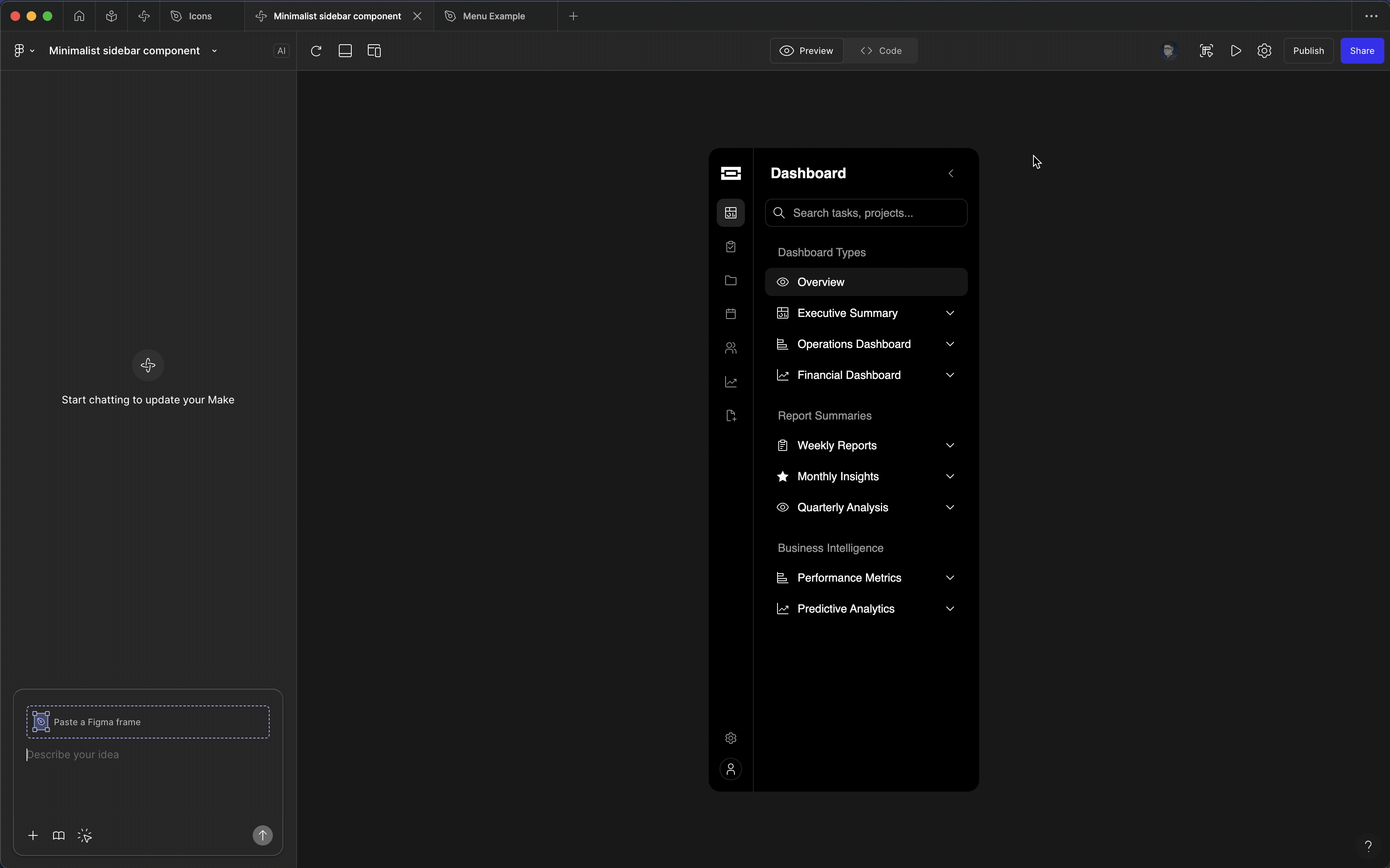

Dec 1, 2025 1:14 AM UTC
You can click the “Copy Design” CTA up top in Make, go to your design file and paste. This is a relatively new feature from Make, so idk if you came across it already.
Do wish it’d create/match components from an existing Design System library though. But if you’re starting fresh it should do the trick, you can then start componetizing from the frame based layout that you paste in the design file.
​@miggi , wondering if y’all have been thinking about component matching as an upgrade to Make for the next Config, that’d be sweet!! 👀 #design-system-magic
