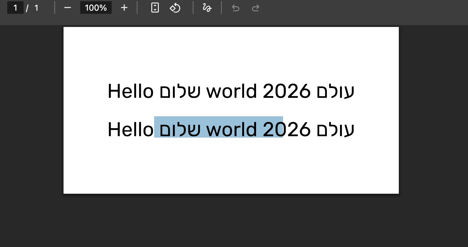

My quick test:
  • I made a new Design file
  • Added a single text layer
  • Used this mixed-script string as my control:
Hello שלום world 2026

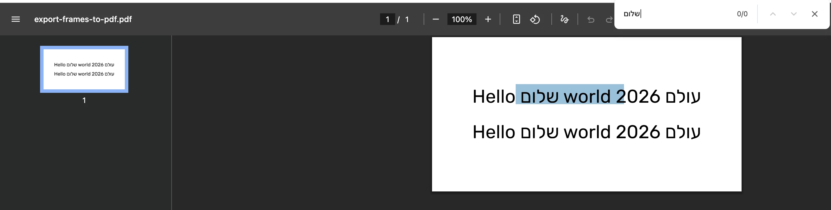

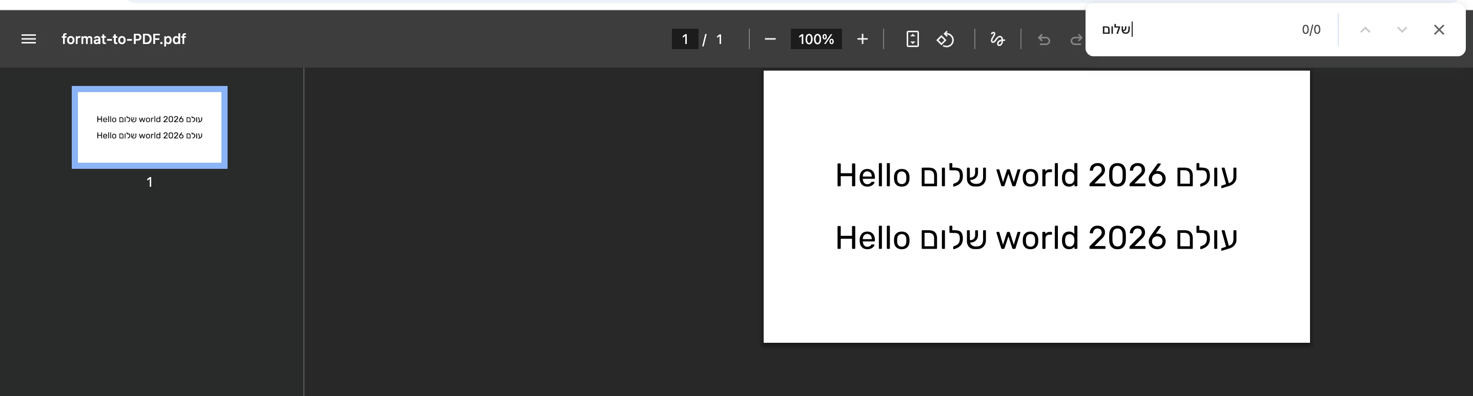

  • Exported via both PDF paths (right-panel Export set to PDF, and File → Export frames to PDF)
  • In the exported PDF, I then: drag-selected across the line, ran Cmd+F for the Hebrew word, and tried to copy-paste it into a plain text editor
What I found: the Hebrew highlights when I drag-select (so it's not flattened to vector shapes), but Cmd+F for the Hebrew word returned no results in any test. So the export carries visible glyphs but a broken character mapping for the Hebrew. This could explain why it can't be searched, copied, or read by tools like ATS, even though it looks like normal text.
