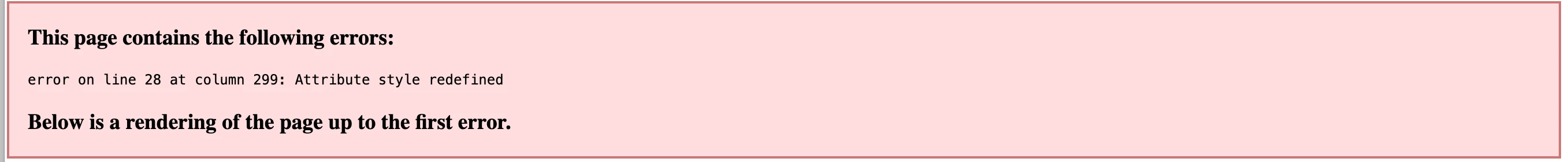

Exporting SVGs in P3 Colorspace injects an additional style attribute for color-profile metadata, causing the element to end up with two style attributes which leads to an error
Exporting SVGs in P3 Colorspace injects an additional style attribute for color-profile metadata, causing the element to end up with two style attributes which leads to an error. This breaks the SVG and we can’t deliver our SVG illustrations to Development through Figma.
To fix the illustration, development needs to manually delete the additional style, added by the Figma Exporter. That fixes the illustration, but requires a lot of manual labor.
