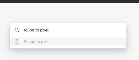

You can either manually change its coordinates from the Properties Panel, or by using the Round-to Pixel function from the menu. Here is how to use the Round-to-pixel function:
  1. Select that object and go to main menu - from there choose quick actions
  2. Search for Round to pixel and click this:

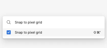

We’d also suggest also activating Snap to Pixel Grid to see if that helps. You can also enable it from the main menu - Quick actions:
Hope this helps!
