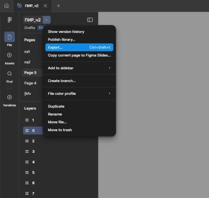

Hi, I have a problem with export. I usually use function “export frames to PDF”, because my drafts is a presentations (always). But some time ago, this feature disappeared, and the usual export remained, which does not suit me (it exports frames one at a time to different PDFs, and I need to export ALL the frames to one multi-page pdf file). plz help, i am so tired for this. I add a picture, how it was before, and what it is now.

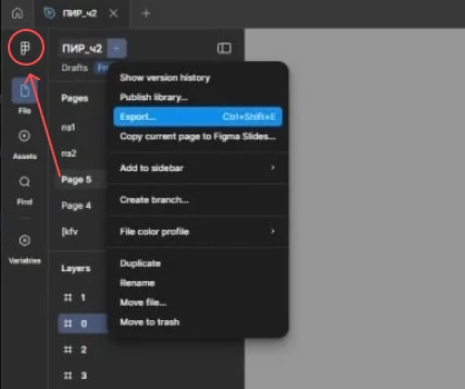

You need to click here instead

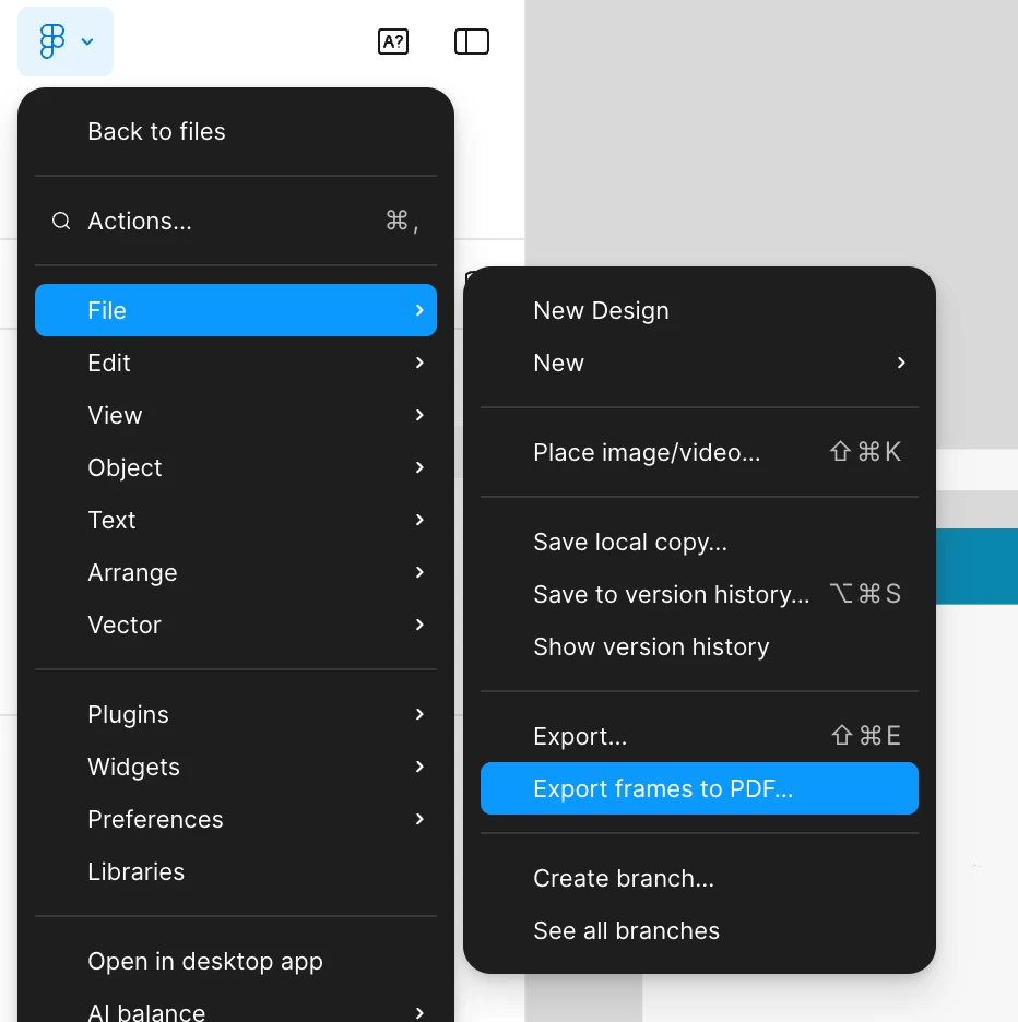

Thank you ​@Nellya  for calling it out. Sorry about the confusion here, I totally missed the part that you’re seeing this in the new left navigation bar.
I just double-checked on my end, and the “Export frames to PDF” option is available in the new left navigation bar. You should be able to find it under the Figma menu.
