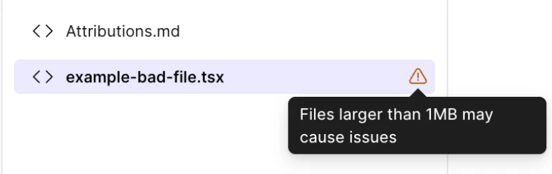

    If so, this usually happens when one or more files in the project exceed the 1MB size limit, which prevents the AI chat in Figma Make from functioning properly.
    To resolve the issue—although you may have already tried this—please double-check for any oversized files.
    These will be marked with a warning icon next to the filename in the left sidebar of the Code editor: You can try shortening or deleting the problematic files.
    Once those files are fixed or removed, you can prompt Figma Make again to resolve any issues introduced by shortening the files.
    If the steps above don’t work, try duplicating your file and starting fresh with the optimized content.
