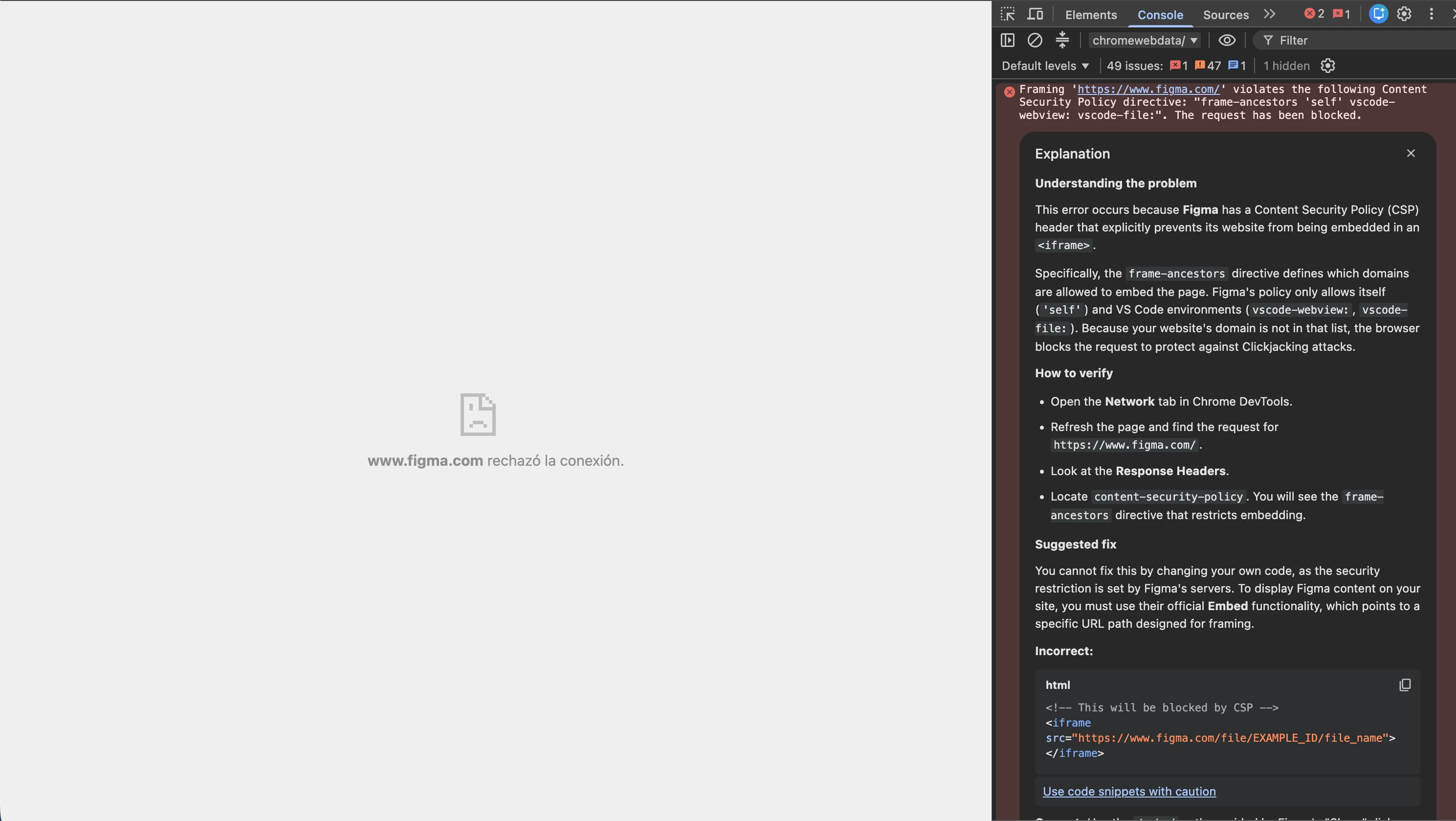

We’ve been using Figma Design for a while now to host interactive presentations via embeds. Earlier this week something changed in our Enterprise Account setup and we no longer can add any embeds. Is this related with the setup only or are embeds not supported anymore under certain conditions?

Hi, ​@Camila_Hermida_Romero 👋 Thanks for reaching out. A couple of quick questions to help us get started:
  • can you tell us more about the file type you are embedding?
  • have you tested with other files types? Are GIF, MP4s, etc giving the same error
  • Desktop or browser Figma? Your OS and browser?
