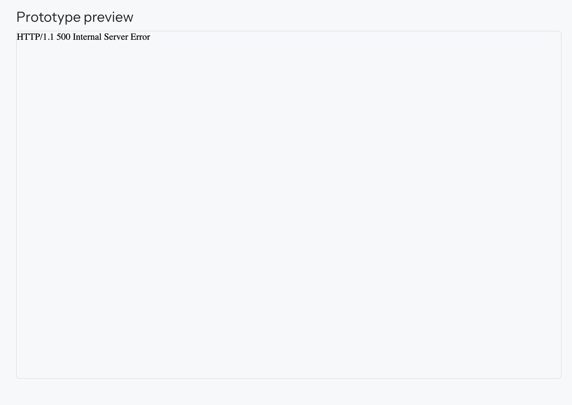

We're seeing a consistent HTTP 500 from https://www.figma.com/embed?embed_host=share&url=... when the viewer's browser is logged into Figma. Same embed URL, same file:
  • Logged out → works
  • Logged in → 500
Repro is just: open a prototype embed iframe while logged in to Figma on the affected account. The 500 happens during what looks (from devtools) like an internal refreshOnReadyForEmbed reload triggered by the auth-aware code path.
Reproducible across Chrome, Firefox, and Safari. Setting iframe.credentialless = true (Chrome only) avoids it by stripping cookies, but breaks Figma's password-protected file form, so it isn't a viable general fix.

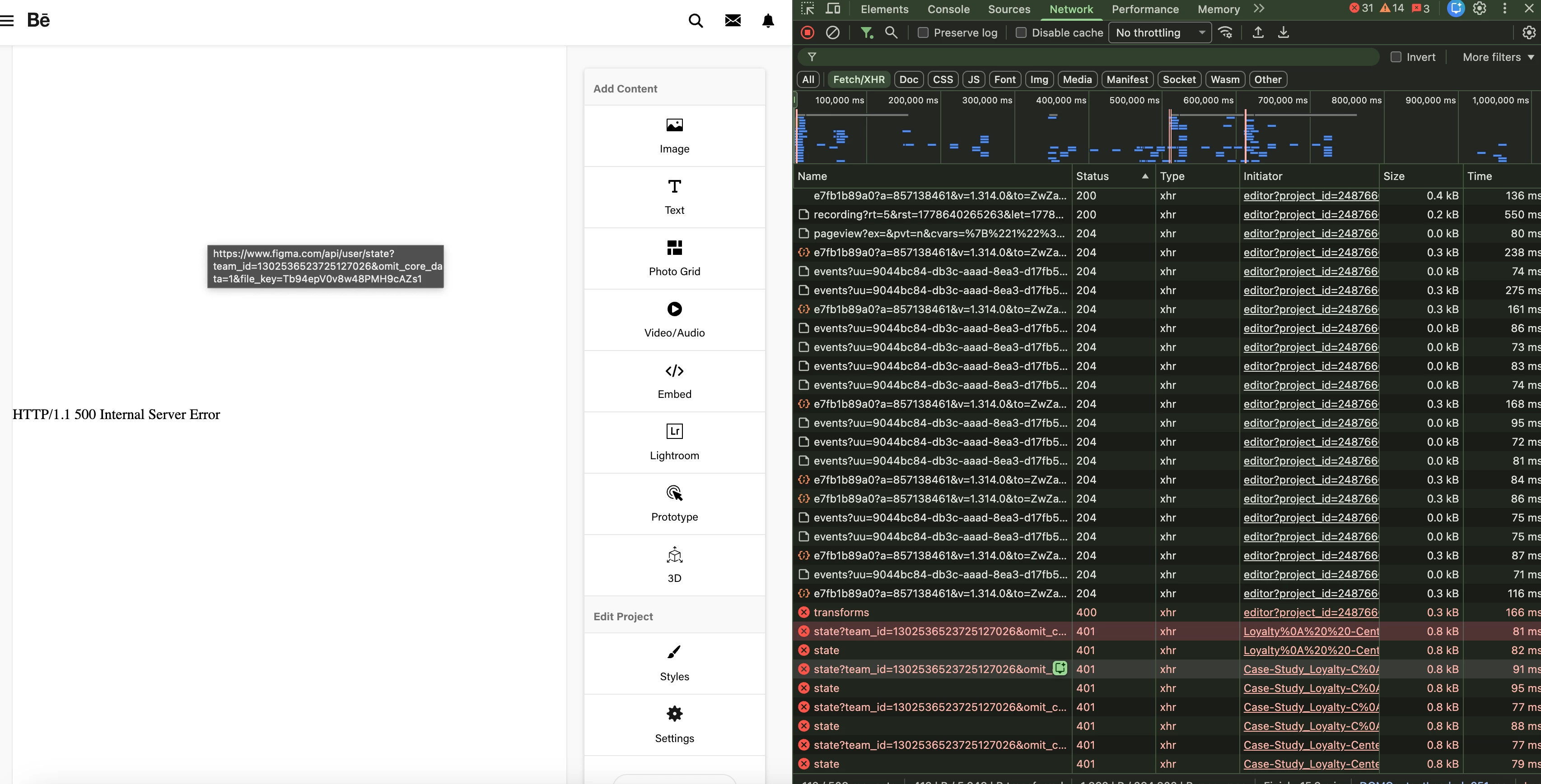

I can confirm this is happening for me as well when looking at my own figma prototype embeds on behance, and looking at other user’s figma prototype embeds.
Response in chrome developer tools is {"error":true,"status":401,"message":""}

I'd also love to swap quick details on the failing request — for me it's GET /api/user/state returning 401, then the iframe's outer response is 500. You're seeing the same 401 body. Do you see __Host-figma.embed cookies in the request headers?

  1. OS/Browser - Mac/Chrome
  2. A few hours ago
  3. Icognito works
  4. Professional
  5. Safari works, but I’m not signed into figma there
  6. I only have my own account to test, sorry!
all headers attached, __Host-figma.embeddoesnt appear to be one

Thanks heaps ​@Tonson Back , this is really useful! A few quick takeaways from your data:
  • Your __Host-figma.embed.mac cookie decodes to {"plan":"pro", expires_at: Jul 2026} — valid, unexpired, plan-stamped. Chrome is even sending it (sec-fetch-storage-access: active). Figma is just rejecting a valid embed session server-side. So it's not cookies or storage.

I’m having the same issue. The  figma prototypes I have embedded in SharePoint are returning the “HTTP/1.1 500 Internal Server Error”. I’ve also tested with a different account, in different device, browser and internet connection, and I’m still getting the same error… It stopped working yesterday morning (CET).
