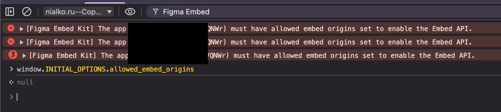

I’m currently trying to integrate the prototype to my site using Embed API. As it was requested in the instruction, I’ve created a new application, added allowed embedded origins and inserted iframe tag with prototype URL (including client-id field in order to enabled Embed API). However, it seems that my origin settings aren’t propagated to the iframe. Whenever I click to the prototype inside the iframe, my browser logs an error message into the console. From what I already discovered, allowed_embed_origins field always comes with null value, regardless of the settings I set. Please take a look
My embed API settings, application isn’t published and is still set to “private”
Error messages (they’re the same on any of the specified origins)
