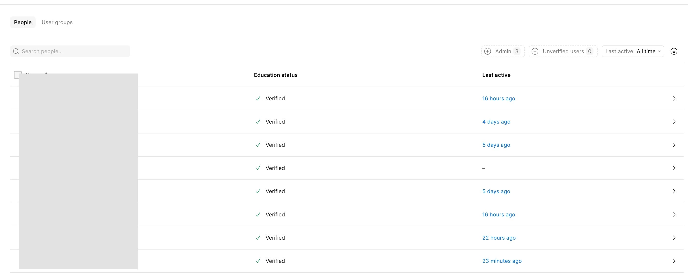

  • We have a team on the Education plan. All accounts/members show "Verified" under Education status in the People tab, and there are 0 unverified users.

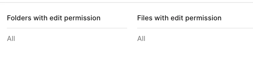

  • The team has "can edit" access to the team and folder ("Anyone in [team name] can edit").
  • On the file's Share dialog, the team also shows "can edit".

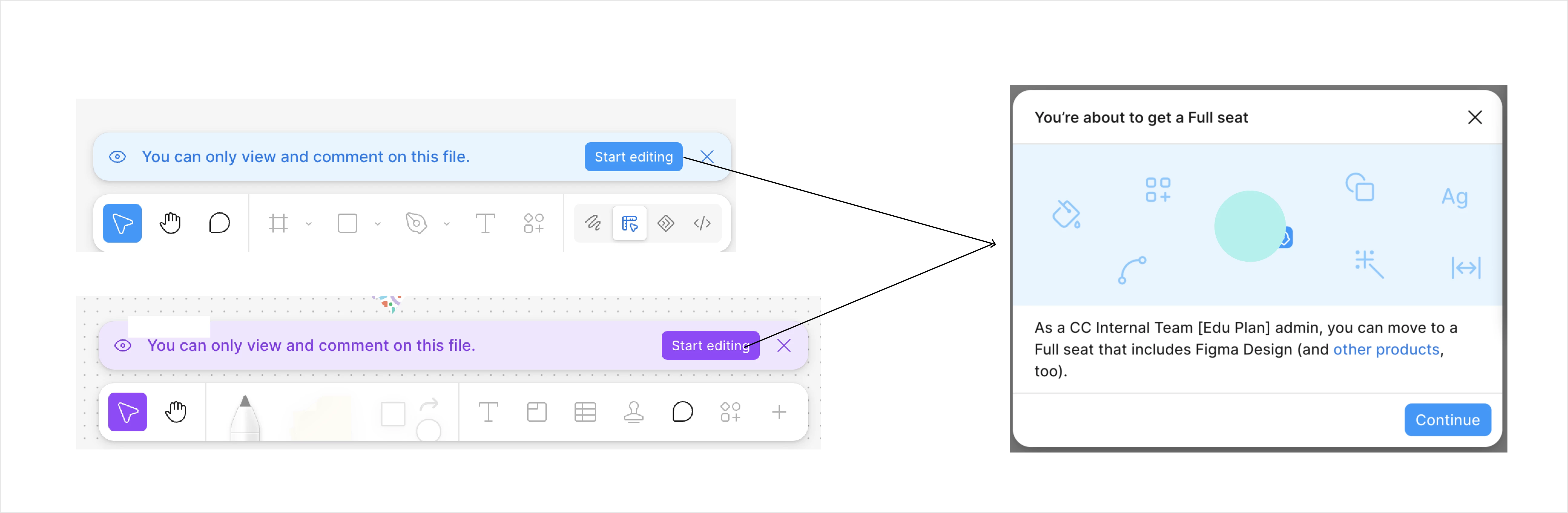

  • When a member (not the file creator) opens the file that others created, a banner says "You can only view and comment on this file." with a "Start editing" button.
  • The members are signed in with the correct account (our organization's email) and have selected the correct team.
  • After clicking "Start editing", a "Continue editing" confirmation appears, and only after confirming can they edit.

  • Permissions at team, folder, and file level are all "can edit" (screenshots attached).

1. Full confirmation screen
The attached screenshot shows what a member sees when opening a file created by someone else. The top banner is Figma Design and the bottom one is FigJam. Clicking "Start editing" opens the "You're about to get a Full seat" dialog (right side). After clicking "Continue", the member can edit the file. Nothing else appears afterward.
2. Reopening the same file

The People tab for our Education team doesn't show a permission column. It shows only Education status and Last active. The attached screenshot shows all members as Verified, with 0 unverified users. For permissions, the folder and file Share dialogs both show "Anyone in CC Internal Team [Edu Plan]: can edit".
