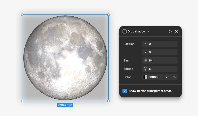

If anyone facing problem while appling drop shadow effect on transparent png images?
I get the shadow as a box instead of circluer shaeow.

This definitely seems odd. Drop shadows in Figma Design should follow the transparent areas of a PNG rather than its bounding box, so a square shadow points to something fixable. A few things to check:
  • The "Show behind transparent areas" checkbox: Open the effect settings (the ⚙️ next to your Drop shadow) and make sure it's unchecked. When it's on, the shadow renders behind the full layer, which looks exactly like what you're seeing.
  • Where the effect is applied: If the shadow is on a parent frame or group instead of the image layer itself, it'll trace that container's rectangle. Select the image layer directly and apply it there.
  • The PNG's actual transparency: Some export settings flatten the background or leave it at a very low opacity instead of fully transparent. Dropping the image onto a dark background is a quick way to spot it.
More on the effect options here: Apply shadow or blur effects. If none of these help, could you let us know:
