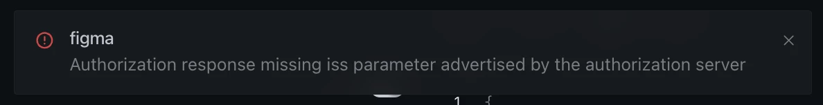

When try to authenticate Figma MCP in Devin I am getting the following error,
Streamable HTTP connection failed for 'figma-remote-mcp-server' at 'https://mcp.figma.com/mcp': Auth required, when send initialize request: Auth required: Auth required: authorization required: Bearer resource_metadata="https://mcp.figma.com/.well-known/oauth-protected-resource",scope="mcp:connect",authorization_uri="https://api.figma.com/.well-known/oauth-authorization-server"

Figma's MCP OAuth metadata advertises authorization_response_iss_parameter_supported: true, but the authorization response does not include the iss parameter. MCP clients that validate per RFC 9207 reject the callback, so the token exchange never happens.
Reproduce (step 1 needs no credentials):
curl -s https://api.figma.com/.well-known/oauth-authorization-server → "issuer": "https://api.figma.com", "authorization_response_iss_parameter_supported": true
Then run any RFC-9207-validating MCP client through the flow. The user approves in the browser, the redirect returns without iss, and the client aborts with: "Authorization response missing iss parameter advertised by the authorization server".
Identical metadata is served at both mcp.figma.com and api.figma.com (byte-identical).
Expected: either include iss=https://api.figma.com as advertised, or set the flag to false so clients skip the check. The former is correct per RFC 9207; the latter is a one-line unblock.
Impact: any RFC-9207-enforcing MCP client cannot connect at all. The consent screen succeeds and still yields no token, so it reads as user error rather than a server bug.
Distinct from forum topic 52978 (403-instead-of-401 before auth) — this one happens after approval.
Server-side fix; no client or account change helps.

I understand how this must be disrupting your workflow. The metadata at api.figma.com does advertise authorization_response_iss_parameter_supported: true. I’ll flag the mismatch between that and the authorization response with our team. Two questions to make sure we've captured your case accurately:
  • Which MCP client and version are you running, and are you pointed at mcp.figma.com or api.figma.com?
  • Roughly when did you last attempt the flow? A recent timestamp helps us line your attempt up against what's deployed.
Let me know, and we’ll continue troubleshooting this together.

Our MCP team confirmed that they updated their MCP server authorization to adopt RFC 9207 recently and released an update on Sep 10 to support this RFC. Can you please make sure that you’re on the latest Devin version? v3000.10.21

Same here. Trying to connect Figma with Hermes Agent via MCP oAuth yields in missing iss parameter.
URL is https://mcp.figma.com/mcp
Last tried: just now.

Our MCP team confirmed that this is a bug. The team updated their MCP server authorization to adopt RFC 9207 recently and released an update on Sep 10 to support this RFC. Can you make sure that you’re on the latest Devin version? v3000.10.21

Thanks ​@djv for your fast reply. The bug was also discussed in the GitHub Repo of Hermes and with the latest update a iss-specific workaround was introduced (cloudflare had the same problem) - so today, it works again for me!
