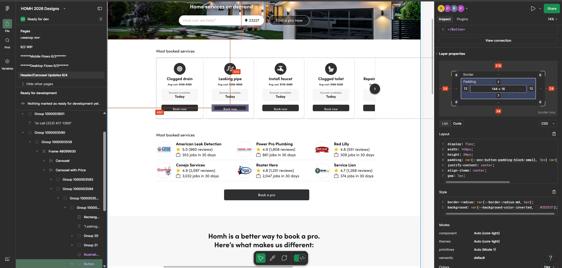

Developers are seeing something different in my file than what I see

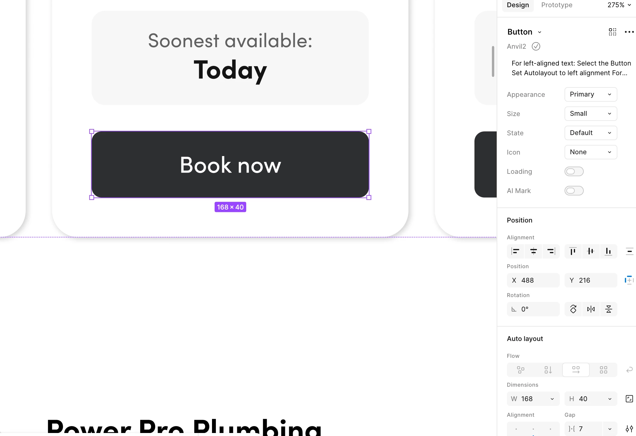

    Hey hey ​@Liz Gershman 👋 Thanks for the question. I have a few follow up questions and a quick test for you to try.
    Test:
    • Select the broken "Book now" button (Leaking pipe card), then screenshot its Fill section (not too zoomed please)
    • Repeat for a working button (e.g. Clogged drain) and compare — solid fill vs. pattern/image fill?
    • Check whether the broken one is a clean instance or detached/overridden
    • Have the dev hard-refresh and confirm whether the hatch persists
    Questions:
    • Is it just the one button on the Leaking pipe card, or showing up across other screens too?
    • Are you and the dev on the same branch and version?
    • Is the dev in the browser or the desktop app?
    Thanks for the additional info! — Jaycee
