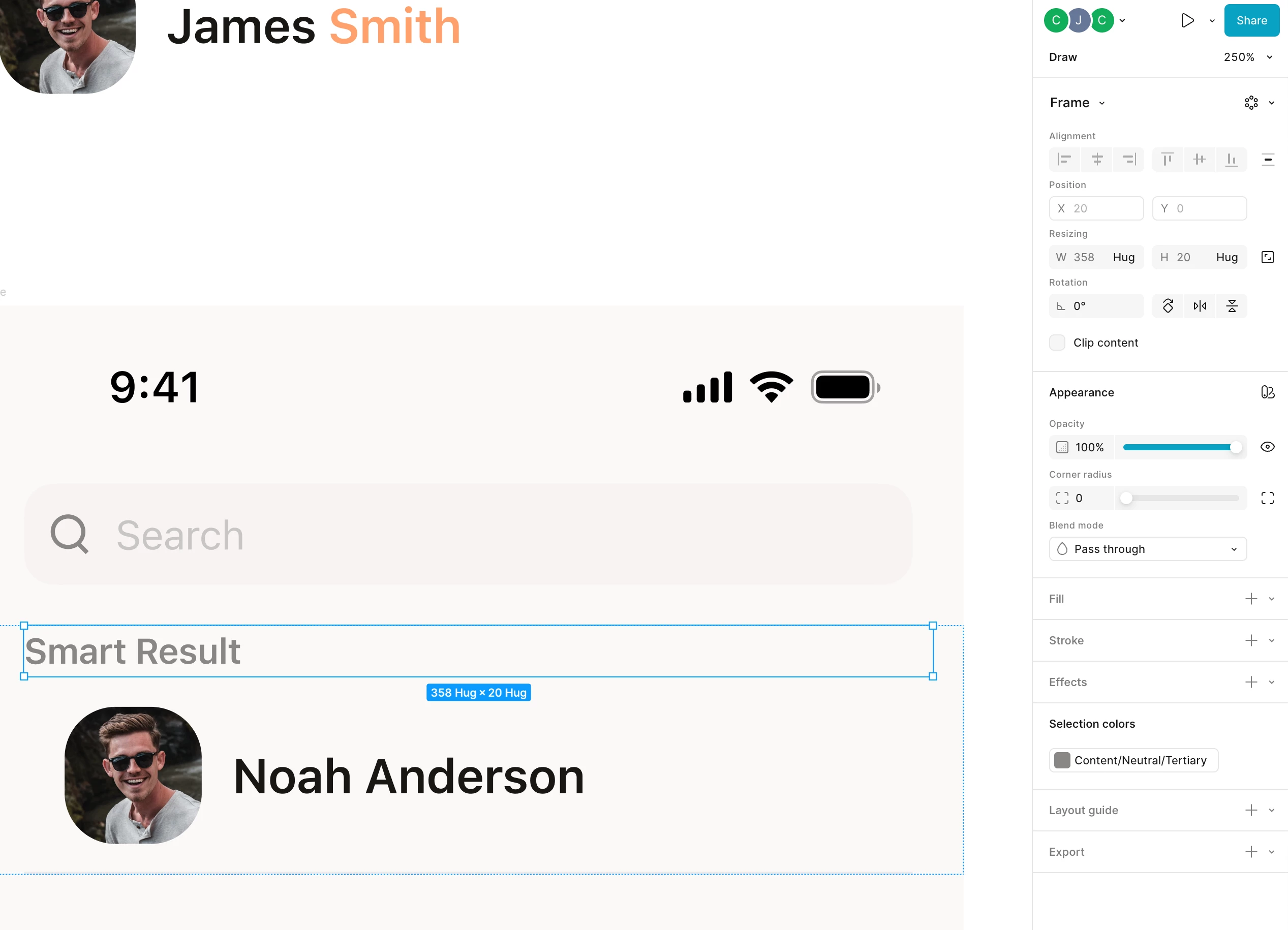

Desktop App Bug: Not Showing Auto-layout Configuration; No Variable Configuration
  • August 5, 2025
  • 138 views
My Desktop app keeps losing some UI in the right side panel. Here is a screenshot of me selected an auto-layout frame but has no auto-layout configuration shown. (My app version is 125.6.5 )
Also, my desktop app does not have variable entrance on the side panel as well. This only happens after I updated to 125.6.x. Does anyone also encountered this bug? Figma Please fix it :(

Hi ​@ConstanzaTong ,
I understand you're seeing missing UI elements like Auto Layout and Variables in the right-hand panel when using the Figma desktop app (125.6.5).
From the screenshot, it looks like you're currently in Figma Draw.
Some features from Figma Design aren’t available in Figma Draw. To access those tools, please try switching the toolbar toggle from Draw to Design.
You can learn more about Figma Draw and the available features in this Help Center article: Explore Figma Draw
