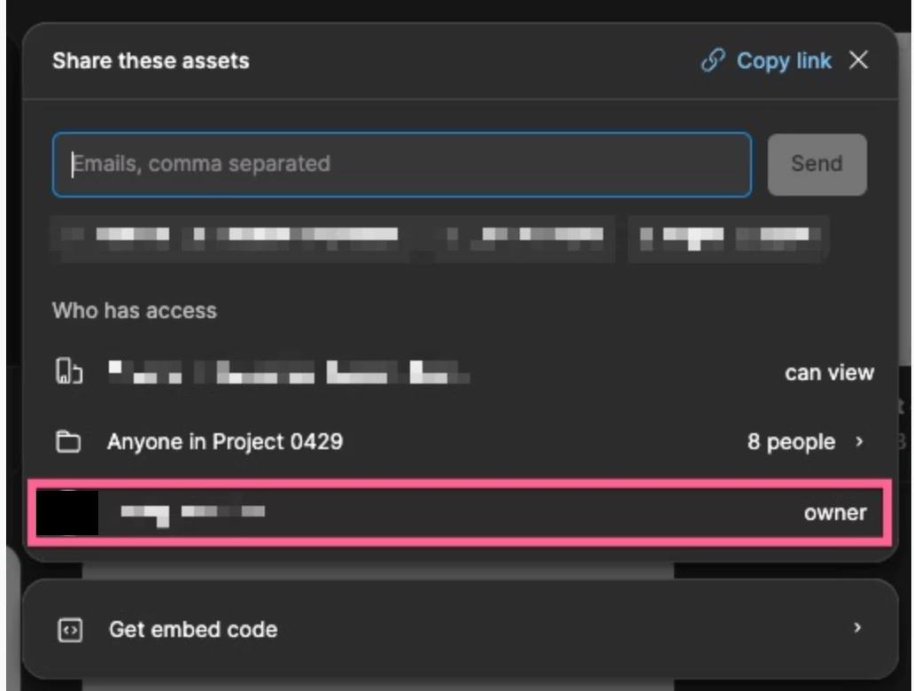

    Hi ​@Gerry Fletcher , unfortunately the file URL alone won't give you much information about the owner. Usually, the easiest way to find a file owner as an Admin is through the Share modal, where the owner is listed at the top (but since you can't access the file right now, that's not an option here.)
    As Adam mentioned, we can create a support ticket on your behalf so our team can investigate further and check the settings. I've sent you a DM with the next steps! Please check it when you can, thank you 🙏
