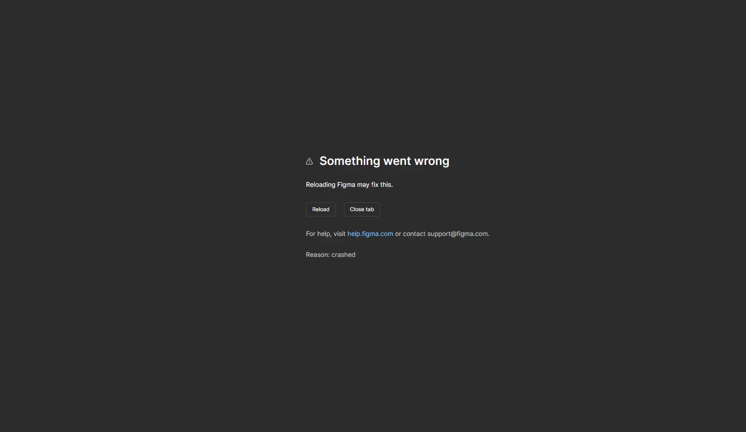

CRITICAL: All "Figma Make" files crashing immediately - React Router Error
Hi Figma Team,
I am experiencing a critical issue where all my Figma Make files have suddenly stopped working. The preview crashes immediately upon loading with a white screen or error message.
This seems to be a deployment regression on your end, as it affects multiple files that were working perfectly before.
The Error: The console throws a React Router v6 error stemming from makeproxy-c.figma.site. It seems an undefined component is being passed to your router configuration.
Stack Trace:
Error: [undefined] is not a <Route> component. All component children of <Routes> must be a <Route> or <React.Fragment>
at invariant (react-router-dom.js)
at createRoutesFromChildren (react-router-dom.js)
at Routes (react-router-dom.js)
Source: https://app-7rewowbl35pf7ves4z6mxxdyr7d3zoduh36vgxqfkug7i6yt7ncq.makeproxy-c.figma.site
Steps Taken:
  1. Cleared Desktop App cache.
  2. Tried accessing via Chrome/Edge (same error).
  3. Duplicated the file (same error on the new copy).
Please investigate this urgently as it is blocking all work related to Figma Make.
Thanks.

I just updated my Figma Desktop App and it seems after every 3rd request in Make it will crash.  I had this happen in previous version 1 or 2 times a week, but not every 3rd or 4th request.

Hi All, thanks for your patience while I team worked towards a fix!
We just pushed an update that should resolve these issues. Please refresh your Make files and please let us know if you run into any further issues.
